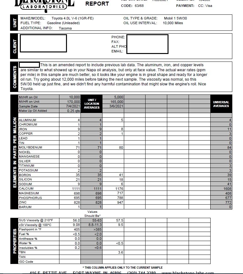

    I have 170k on my truck, did dino oil every 5k up until a year ago. Just got my Blackstone report after 10k on Mobil1 10w30 synthetic with very good results. I daily the truck like a car, very little 'truck' use.
    So based on this I don't see a reason to change it any more often then 10k.

    Thanks for posting the lab results.
    Do as you like. 10k- 12k?
    I can only say, “check the level”
    I personally do - Conventional 5w30 @ 5k.
    I’m too lazy and cheap to send of for a report.

    I sampled when I changed the oil at 10k. Sent in for the report because I was curious about oil condition at that point (I used to do 3k oil change before the taco), and overall condition of the engine at 170k (coolant, gas, metals in oil). Now I won't be worried if I do a few miles past 10k before an oil change.

    Thanks @MadRussian for posting your report, Good stuff right there :thumbsup:
