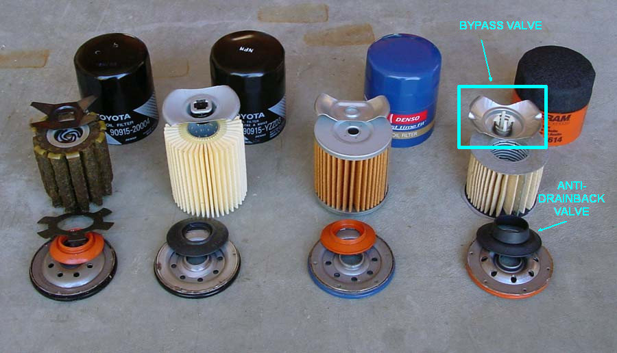

  11. Oct 27, 2021 at 6:43 PM
    #71
    3JOH22A
    3JOH22A トヨタ純正男娼
    Mar 27, 2019
    #288172
    13,215
    District 6ix
    3G Tacoma on 35"s, 5G 4Runner
    Don't confuse the anti-drainback valve with the bypass valve. On spin-on filters, the anti-drainback valve is the rubber flapper visible through the holes on the filter end. The bypass valve is the spring-loaded end cap on the far end of the filter center tube. The 2GR OEM bypass valve is built into the filter housing cap.
