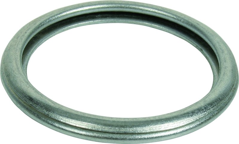

    Subaru uses an actual crush washer that needs to be replaced at every oil change... as @Speedfreak has noted. However, that is not the case with Toyota.

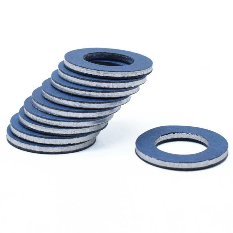

    The diffs etc use a crush washer and the oil pan uses the flat fibre washer. At least on my truck which admittedly is not a 3rd gen.
    Are you using the wrong washer? Snug is snug you don’t need to even use a torque wrench for the oil pan. Just get it nice and snug with a good sized ratchet.
