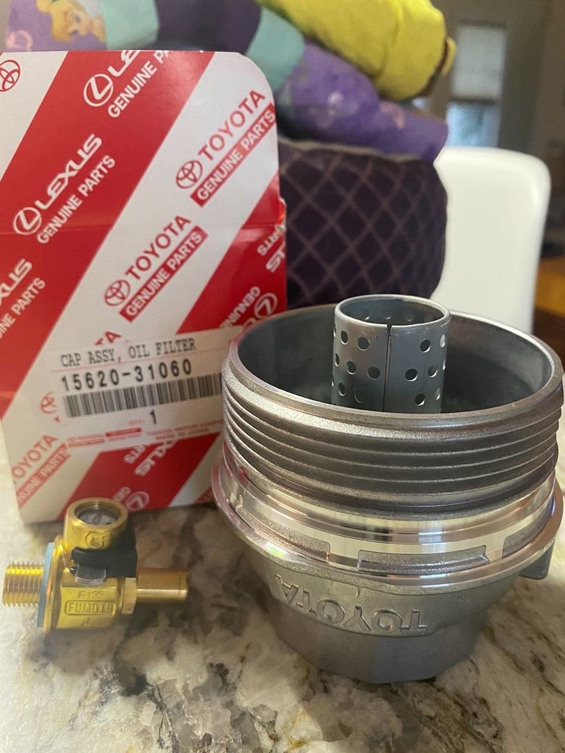

    Toyota is famous for using the same part on different vehicles. This filter housing is one of those parts. It cuts down on production parts needed and helps with parts inventory both at the factory and at the local dealership.

    Does that part number replace the plastic oil filter housing on your 2021 Tacoma? According to Toyota parts it doesn't match when I checked.

    it won't match because the "right one" is the plastic one, it will fit and work right.

    But as stated by @saint277, it should work.

    yes it fits, I put one on a 2017 Tacoma and 2018 4runner, and have one on its way for the 22 runner.

    Actually there is nothing wrong with the filter housing, it just needs to be torqued correctly and it comes off very easily every time. Of course you need to own and use a torque wrench to do that though.

    No need. It's an oring seal. Turn the housing until it hits the flange. Done. BUT you should have a decent torque wrench
