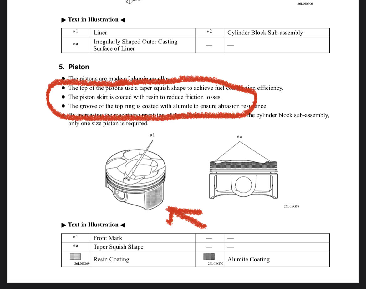

    You're being ridiculous expecting a new truck. How did lack of oil damage the body? Interior? Suspension?
    Extended Powertrain warranty? How does engine running out of oil damage the trans? Transfer case? Axles?
    As stated, borescopes will tell you nothing. Your damage is in the bearings, and possibly the cams/lifters. No oil pressure for even a few seconds is all it takes. Cylinder wall scoring very likely won't happen that fast.
    Pistons are coated, have been for years. They slap the piston wall all of the time. There isn't enough pressure to cause damage, the oil film
    on the cylinder wall is all they need. The coating reduces friction. These days, every little bit helps fuel mileage.
    Check the oil filter? Really? If there wasn't enough oil to create oil pressure, how would metal shavings get to the filter?
    The dealer hasn't touched the truck yet, I'll almost guarantee it. It won't be looked at until the service manager is in the building.
    OP, a long block is probably the best you'll get. The dealer will fight that tooth and nail. The good thing is, you have their truck, they will want it
    back as soon as they can get it back. Not sure lawyering up is the best solution, but a consult couldn't hurt. Be firm but not ridiculous. You want to be made whole, they're the ones that fucked up. There is not a doubt in my mind that there is bearing damage. The bottom end needs to be redone. The long block is probably cheaper than the labor to tear down, measure and replace what needs to be replaced and reassembly.
    FYI, I raced for almost 20 years. Built my own engines. I know what oil starvation will do, it gets expensive real quick.
    And for the record, I don't look under my vehicle after an oil change, I trust (expect) dealer techs to be competent. Shit happens sometimes. Luckily not to me.

    They have a coating to reduce friction on the piston skirt. Give me a moment and I’ll drag it up from the interwebz.
  11. Apr 24, 2022 at 6:54 PM
    #91
    Stocklocker
    Stocklocker Well-Known Member
    May 15, 2017
    #219125
    12,747
    17TRDORDCSBAT
    Here you go:
    http://www.toyotareference.com/guts/tacoma16_engine.pdf
    found on page 77: “the piston skirt is coated with resin to reduce friction losses”
