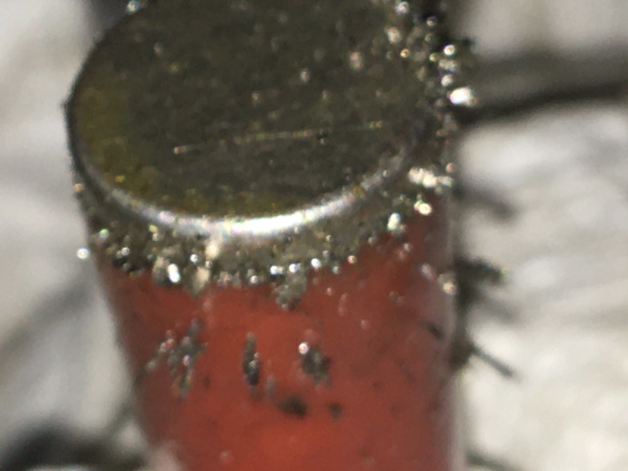

    Very easy to check for damage. Pull the oil filter and inspect the pleats with a magnet.
    We do that on every oil change on airplanes. No fine metal particles or chunks you are good to go.
    I have found fine metal particles that cover the end of a magnet on apparent healthy running engines.

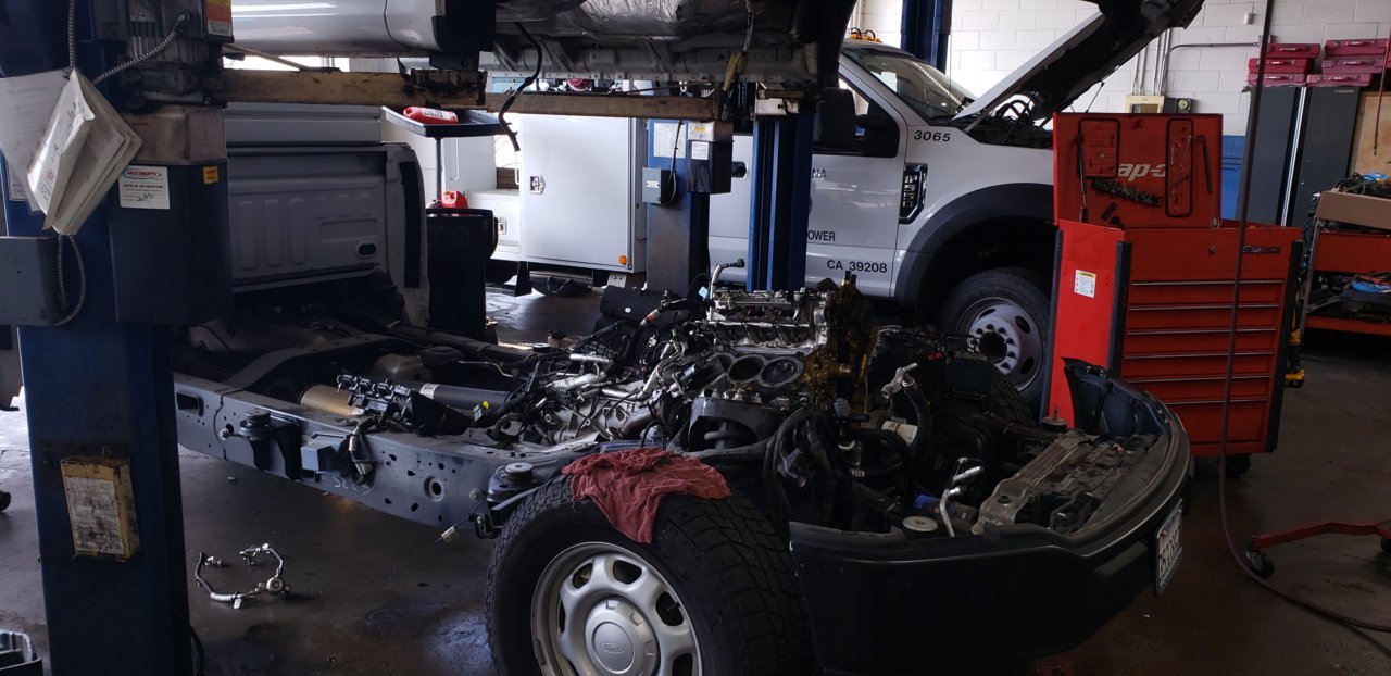

    loss to Toyota/the dealership for a potential buy back, the need to recuperate the loss of the buy back. Labor for a motor tear-down, plus, parts cost for a short/long block motor and one time use items such as gaskets, nuts/bolts etc,etc. for the repair, labor to assemble back. And right now, the most qualifying factor....parts availability. Add those up and good chance that that 7k tacoma will go to auction.
    My dealership and and our sister dealership which is Toyota together recently leased a large vacant lot that is being converted for storage just for our service depts. overflow. My dept. alone which is the Heavy Line Dept. is backed up to about a month and a half wait before we'll work on your junk..

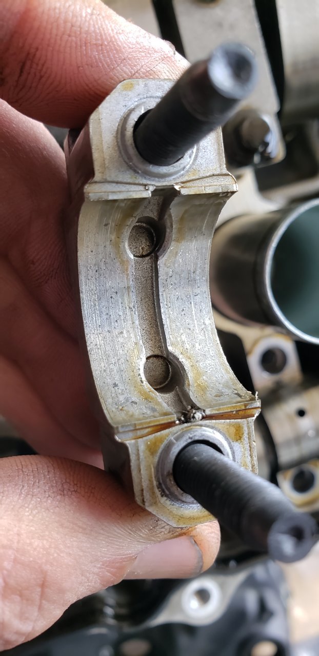

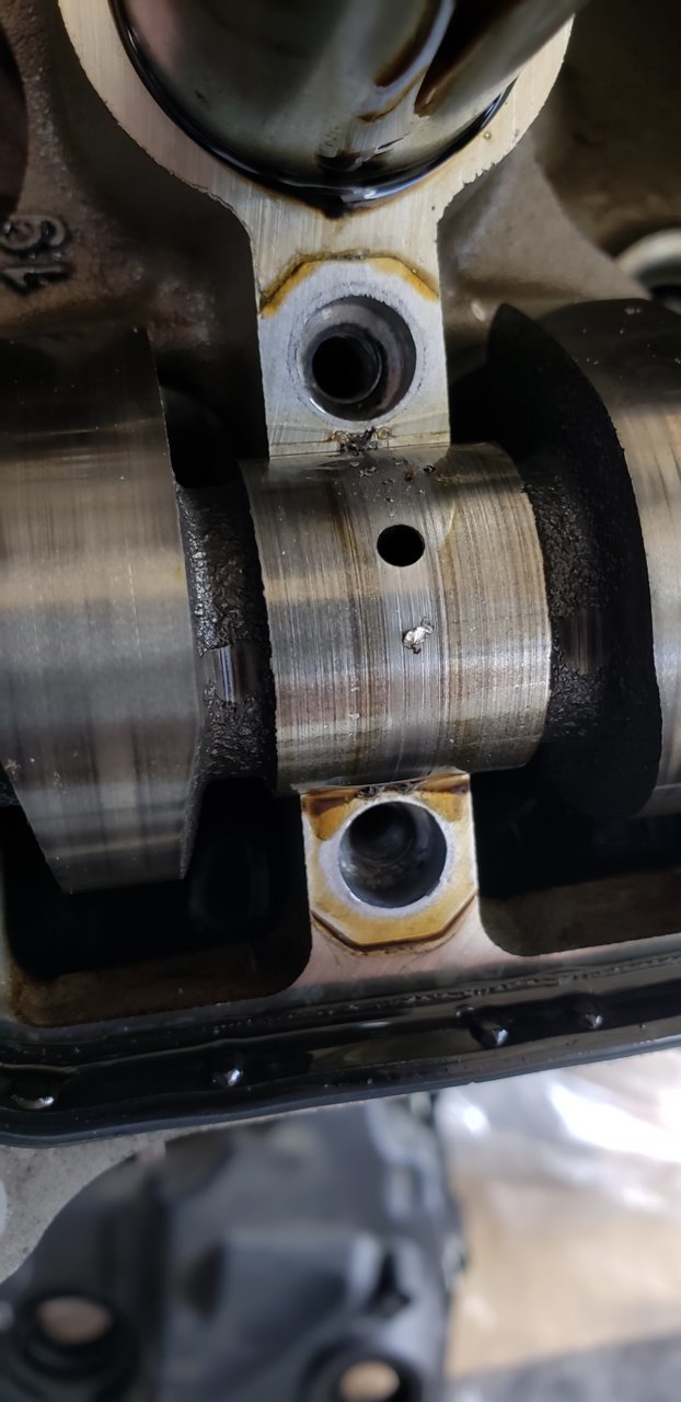

    Another way that is much more conclusive is to remove the valve cover, to access the bearing caps to the cam(s). Remove each cap to inspect the bearing surface looking for scoring of the surface.
    This would be considered "scored". This is from a 6.2L Ford Motor that was remanufactured by Jasper. Scoring happened at 10k miles after I did the swap.

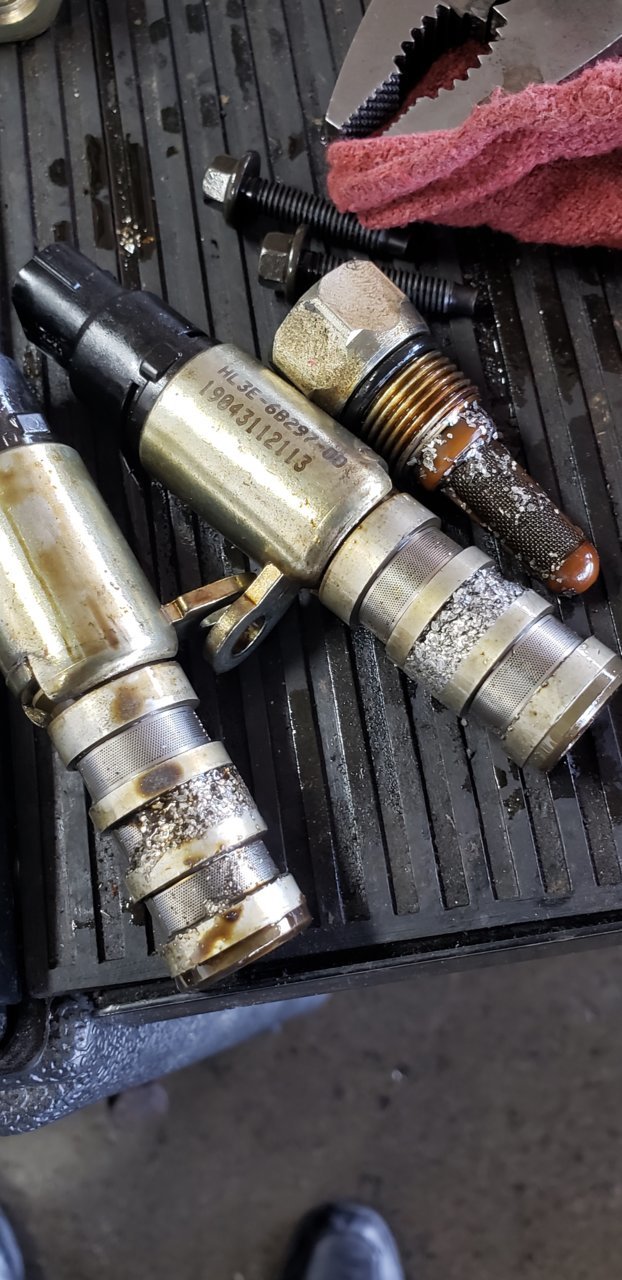

    Another way is to remove the VVT solenoids to check debris/foreign material..

    Do you mind if I ask what happened to the Jasper 6.2? I thought Jasper was high quality and stands behind their product. Just curious..

    Jasper re-man motors have been hit or miss going on the last few years. On this particular motor I believe the bearing sleeves that Jasper used were either out of spec and/or poorly machined. According to the parts dept a new replacement was approved and sent without any hassles. A wrong version of the block was sent and was not compatible with the current motor mounts. A pre 2017 motor was sent. This is where Jasper got screwy, it was recommended by them that we, or a machine shop make the modifications to the block for the motor mounts to work. I'm not drilling and tapping new threads into the side of the block. Eventually the correct motor was sent. Unfortunately it took 6 weeks for it to show up, total down time for the customer was 11 weeks.
    I do hear from the transmission dept. that they never have any issues with the re-man transmission from Jasper.

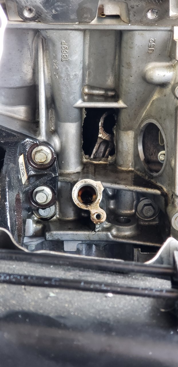

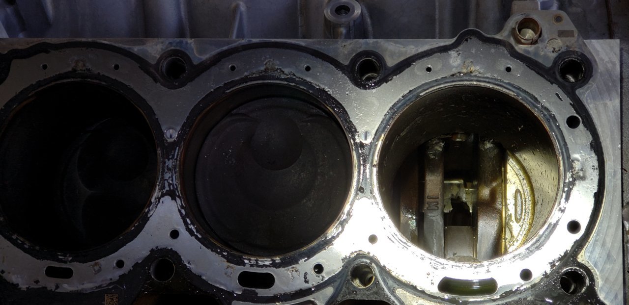

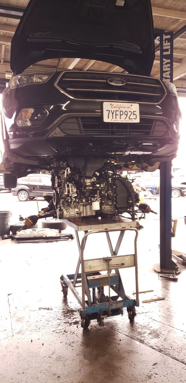

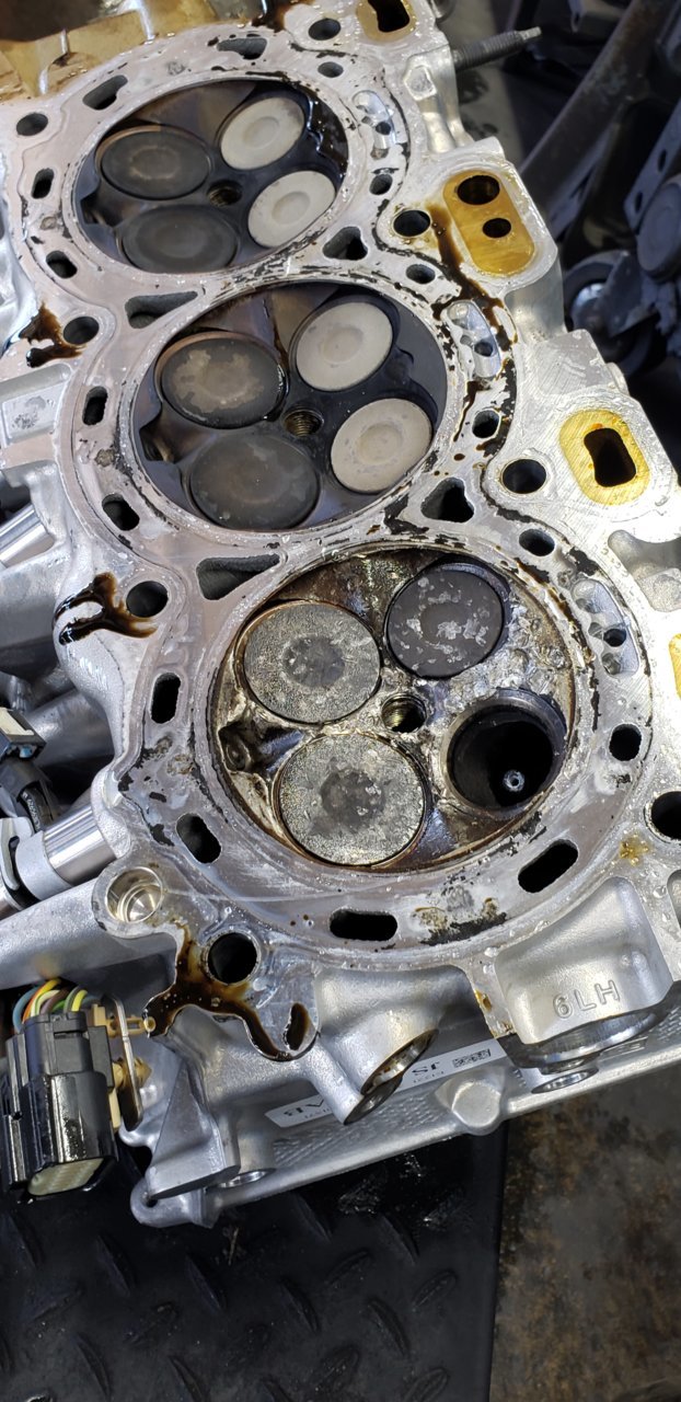

    Forgive my ignorance, but what are we looking at here? How'd it happen?
  19. May 28, 2022 at 2:20 PM
    #1379
    MonkeyProof
    MonkeyProof Power Top
    Oct 7, 2008
    #9774
    12,849
    SoCal- SGV

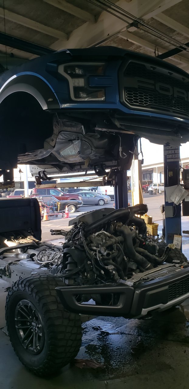

    That is part of the connecting rod to piston #6. Not entirely sure yet of the root cause on this motor. Usually with this motor a fuel injector with be stuck open flooding the combustion chamber with fuel, resulting in a hydrolock condition. Im not able to perform any injector flow tests until its all running again.
    Here are more pics of this motor..
