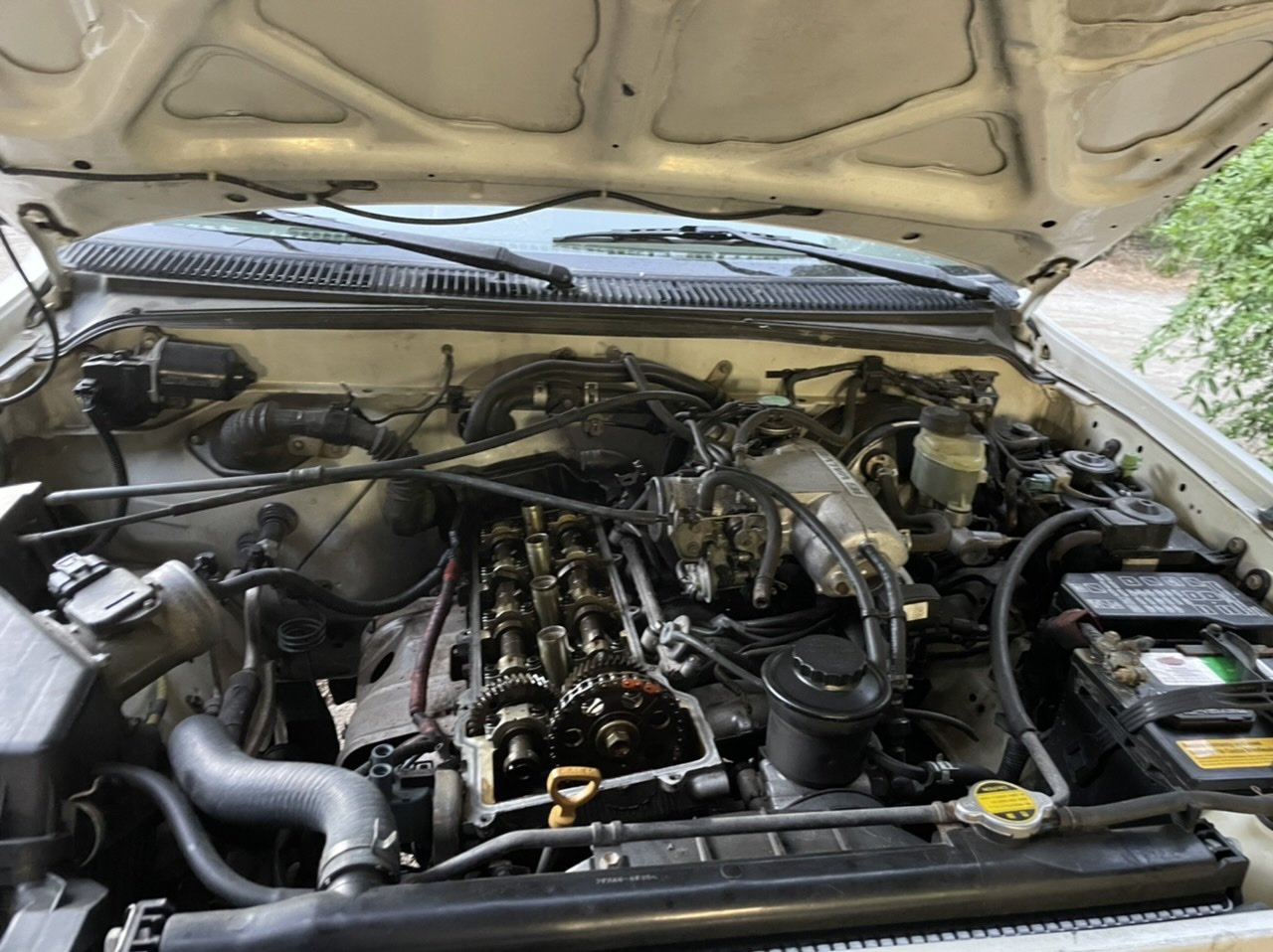

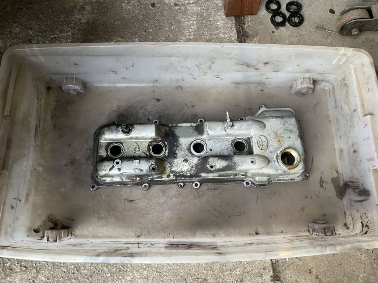

    Went to do an oil change on a somewhat new to me 99’ 3RZ, and it got out of hand quickly.
    I constantly smell burning oil, and now I know why, everything on the Valve Cover is leaking. I can’t stand leaking vehicles.
    This wasn’t the only issue I found, all the Splash Shield bolts were cross threaded, and the oil drain plug didn’t have a gasket, and it was also cross threaded. Oddly I was surprised to see a factory Toyota Oil filter.
    My question is, my oil change ended up with me pulling the Valve Cover to replace all the Seals ect. while I’m in there, is there anything else beside the PCV Valve I should be checking out or replacing?

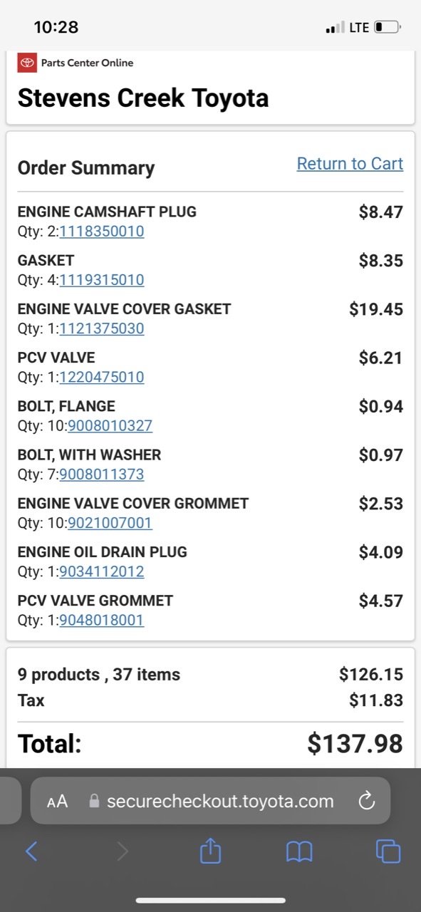

    Here’s everything I just ordered.
    Alright, time to drink.

    Check valve clearance and adjust as needed. You will need a tool for this.
    Not checking can lead to burned up valves eventually

    Is that qty 4 gasket the spark plug tube seals?
    If not, don't forget the spark plug tube seals.
    Absolutely adjust your valves while you're in there

    Yes, those are the tube seals.
    Side note, when I pulled out the Tube Seals there appeared to be RTV applied between the outside of the seal and the valve cover. Is that supposed to be there?
    Normally I research before tearing into something, but this project came up unexpectedly. Looks like there are some good YouTube videos on adjusting the valves.

    No it's not, only time I've seen permatex recommended by Toyota is if it's a metal to metal contact point. Like the half moons, or auto trans pan, or the manual trans intermediate plate, for example.
    Diablo169[QUOTED][OP] likes this.

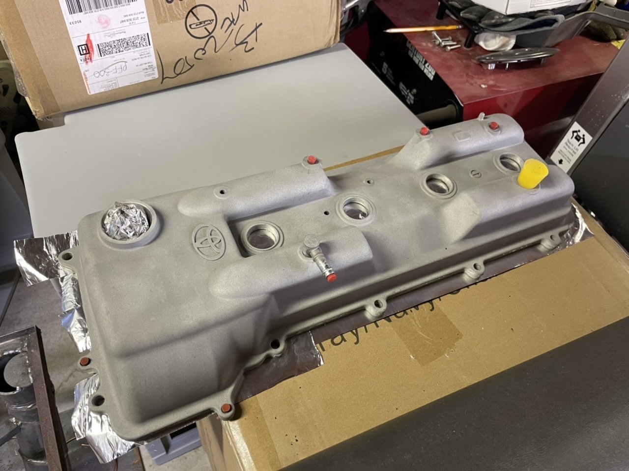

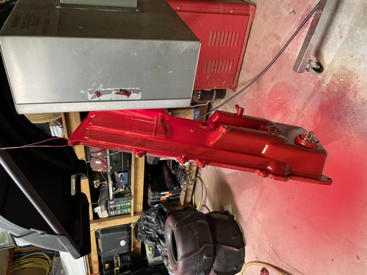

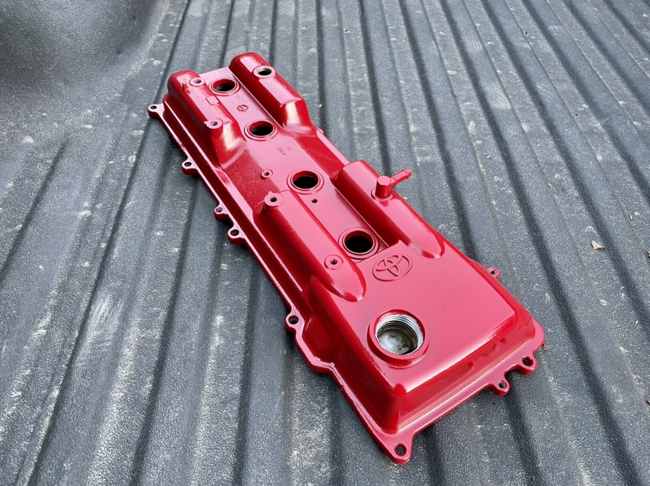

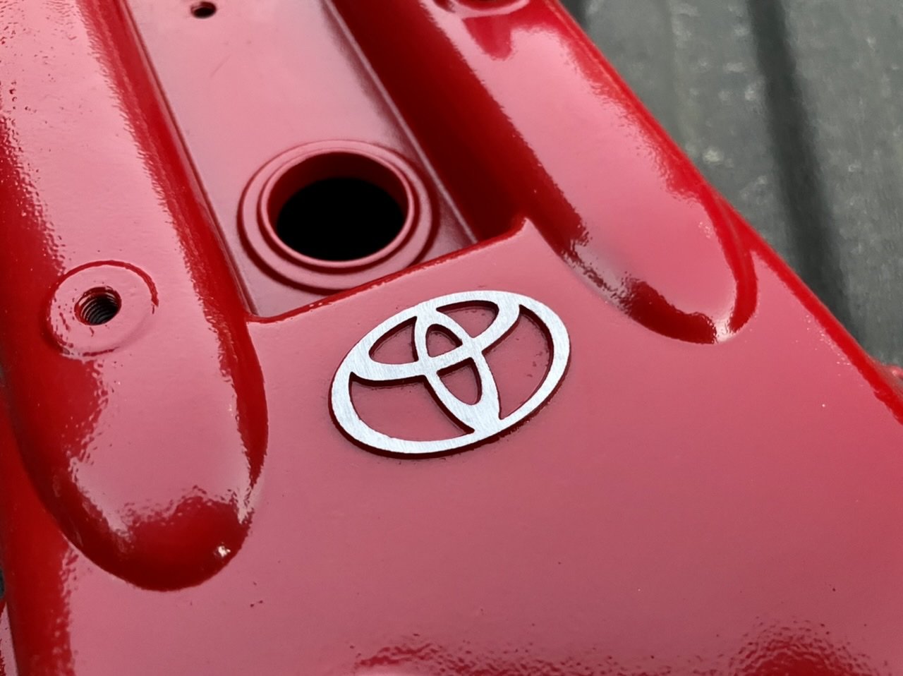

    Project still escalating…
    I cleaned the valve cover with some mineral spirits, sand blasted, and added some red powder coating, then block sanded the logo.
    My Friend said I should be drug tested. :rofl:o_O

    Valve cover looks great. Good job. I’ve accumulated all the parts and tools to perform a valve check on mine. Waiting on my broken ankle to heal now. Going nuts. This thread is perfect.

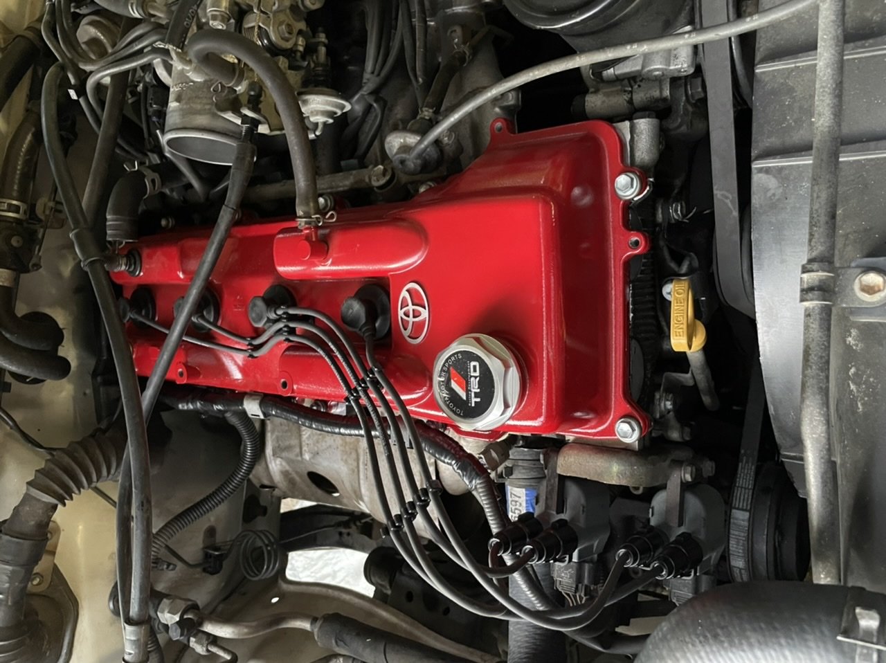

    I never updated, but it’s been all back together and running smooth with the valves all back in spec. I’m digging that 3RZ decal
    I replaced all the broken wire clips and threw on some Denso Wires. Should of gone with sumitumos :frusty:

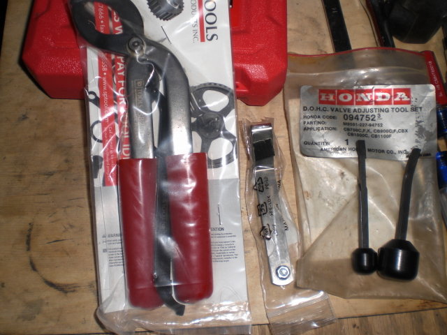

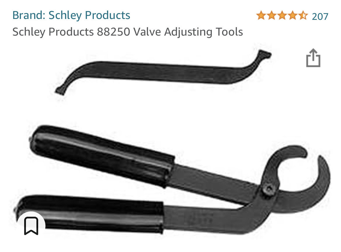

    Funny side note, I ordered the special tool to help with the shim replacement direct from Schely Products, and after months I sent an email asking for an update, and they just sent me a refund o_O
    But now it’s showing 9 available from Amazon with 1 day delivery. :rofl:

    Yeah bought that schly tool off Amazon, had the best price....
    On another thread, they said forget that tool and get the Honda or Kawasaki one,
    and have a buddy help you with it.....much easier.....they say......
