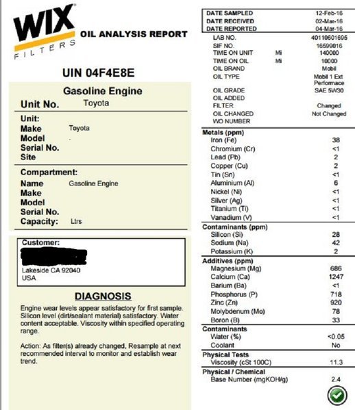

    Mine is on a 10K plan with full synthetic Mobil 1. When I first got my truck, I changed out the 1st oil by 1K.
    Below is my first oil analysis. The TBN value shows I could have gone another 2K+. I would not go 10K on regular dino oil. Check if your manual has a different oil change mileage for severe duty service.
