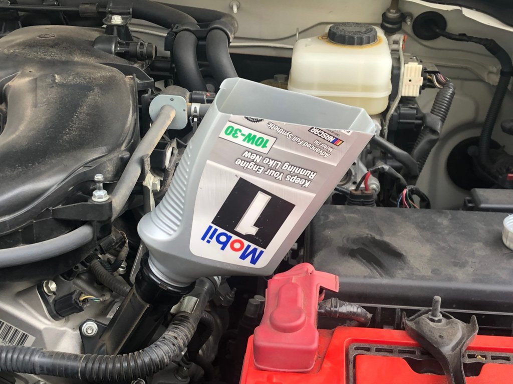

    It's just a free bottle. Also, that's not 2GR.

    Friend of mine insisted to drain the filter housing on his 4Runner TRD Pro, I told him I would custom make a tool for him for $40(it was a joke), he was not amused. It really cost me nothing but a piece of scrap 3/4" CPVC and tubing. You can make one in 30 seconds and less than a dollar. Pop it in, drain and pop it out.

    The worse one in that kit is the funnel. It would work better on a Tacoma if it has the straight wall, because the filler neck is mounted at an angle, the funnel bowl doesn't hold much oil It's easier to spill than the cut off oil bottle. Ice tea bottle works, too.
    I bought the kit before, returned it.

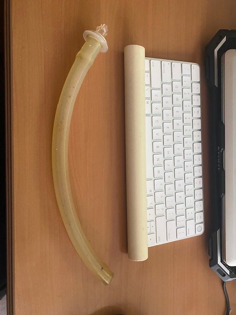

    i'll just throw this out there. i may be wrong so maybe someone that knows for sure can confirm or deny.
    i thought i saw, a long time ago on this forum, that someone had a problem with the perforated tube of the housing
    being too long, he had the wrong part. i think it bottomed out before things were where they were supposed to be so it may have felt like you torqued to the finish but the extra long tube prevented it. anyone remember that? i'm not gonna go looking for it.
    here is example pic for visual aid only, not claiming it is right or wrong:
