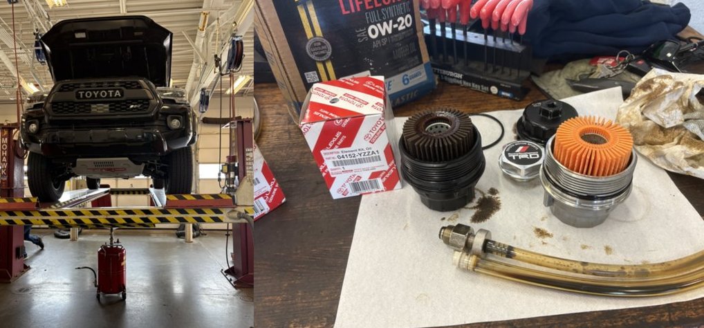

    Yes, these 3rd Gen Engines present quite a challenge for some/all of us with Housing Filter Oil Change.
    But, we are here to engage with one another and enjoy interactions while learning something new.
    Here's a snip-it of last week's oil change at Auto Hobby Shop on Dover AFB.
    My composite housing is my back-up (not weird at all to have it available in my truck) and the Fumoto/Housing Drain Tubes.
    I got 4 filters from Newark ToyotaWorld Dealership (Buy 3/1Free) while I was waiting to have U-Bolts seated properly. (Story in my Intro Thread)

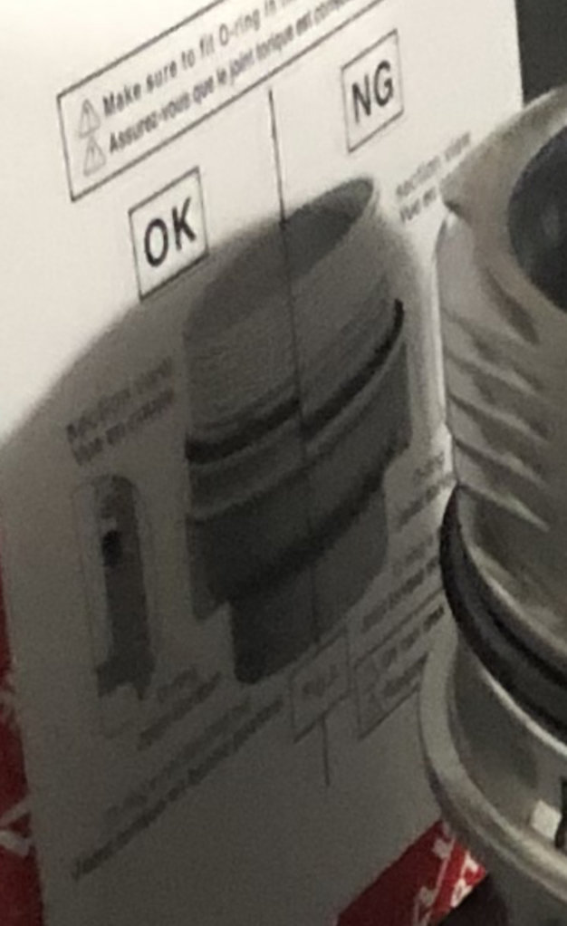

    It shows the o-ring placement on the box.
    The fumoto valve is pretty nice too, minimizes the mess.

    Yes it does - of course that is assuming the one performing operator maintenance looks at the picture carefully and does not assume because they have done it before they already know exactly where the O ring is supposed to go on a housing that is just a little bit different.
