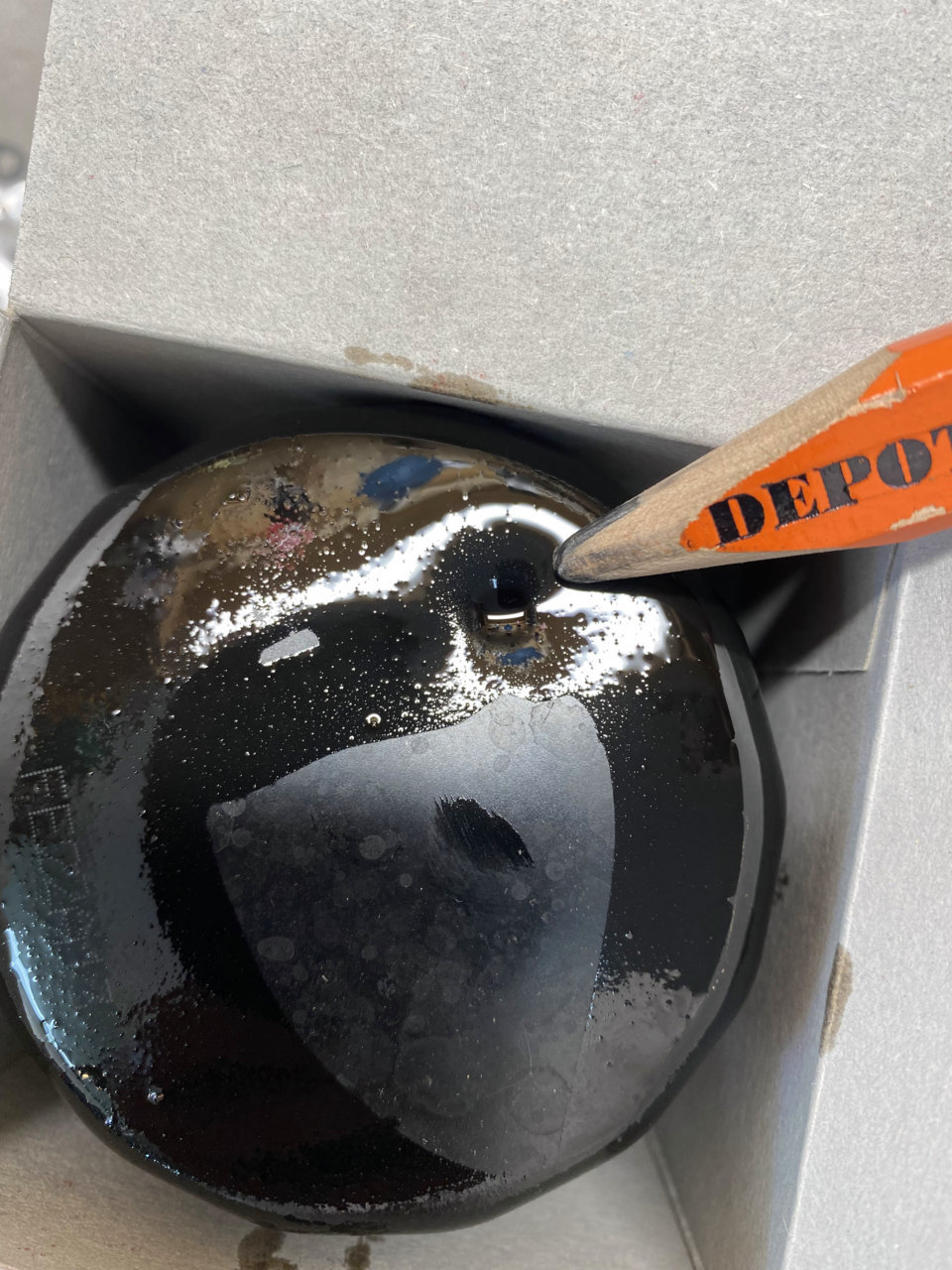

    Hello All, 2019 SR, Auto, 4 cyl. When I was changing the oil I first drained the oil pan then I used a nail to make a hole in the filter and drained the oil from the filter so it would not be as messy when removing the filter. When I removed the filter my arm was still covered in oil. Should I have made the hole in a different spot ? Oil drained from the filter after making the hole, where is this oil coming from ? Thank you for any help/comments.OilFilteer.HEIC.jpg

    Oil is coming out of the engine oil galleries, in the engine block.

    Oil also comes from the very top of the filter, above the anti-drain valve where the top plate is...but even so I get very little oil since I too drain the filter. If you also remove the oil pan drain bolt that will allow those oil passages to drain back into the pan.
