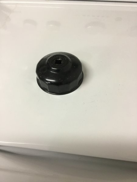

    Made by am/pro for like 20 bucks for oem filters. For 3/8" wrench. For next time.

    I just swapped to OEM filters and need a wrench for my next change

    No link. Bought it at advance or autozone I think it's 68mm part number is AMPRO T70406 . I would buy a second filter take it with you if you go to one of those stores. Just to check.

    This x1000. I use the shittier Craftsman version but it's gotten me out of a lot of pain in the ass filters that some grease monkey strap wrenched on.

    $20???? Those things should be less than $10. Pretty sure I just grabbed a CTA brand all metal one at my local farm supply store for less than $5. They work great until you run into an oddball filter like a Motorcraft where they put a bagillion ridges around the edge instead of 14 flutes. Or Fram where they put rubber texture over the metal so it is too big to fit the filter cap that should fit.
