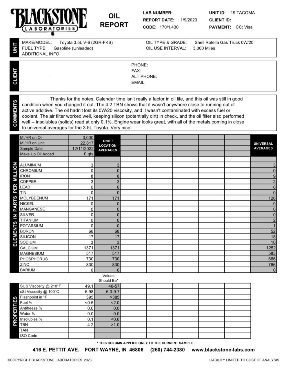

    I drove 3,000 miles in 16 months and the oil (Shell Rotella Gas Truck) was fine. The notion that you must change low mileage high quality GF-6A full synthetic oil at the year mark is a myth.
