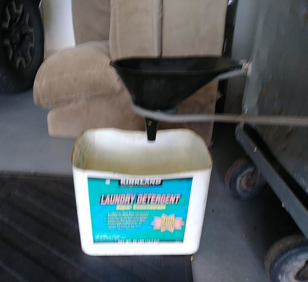

    kahanabob
    kahanabob Well-Known Member
    Feb 19, 2011
    #51477
    2,595
    Maui
    16 TRD 2WD 4DR
    Here is my bucket. Old farts version, use whatever is laying around the shop.
