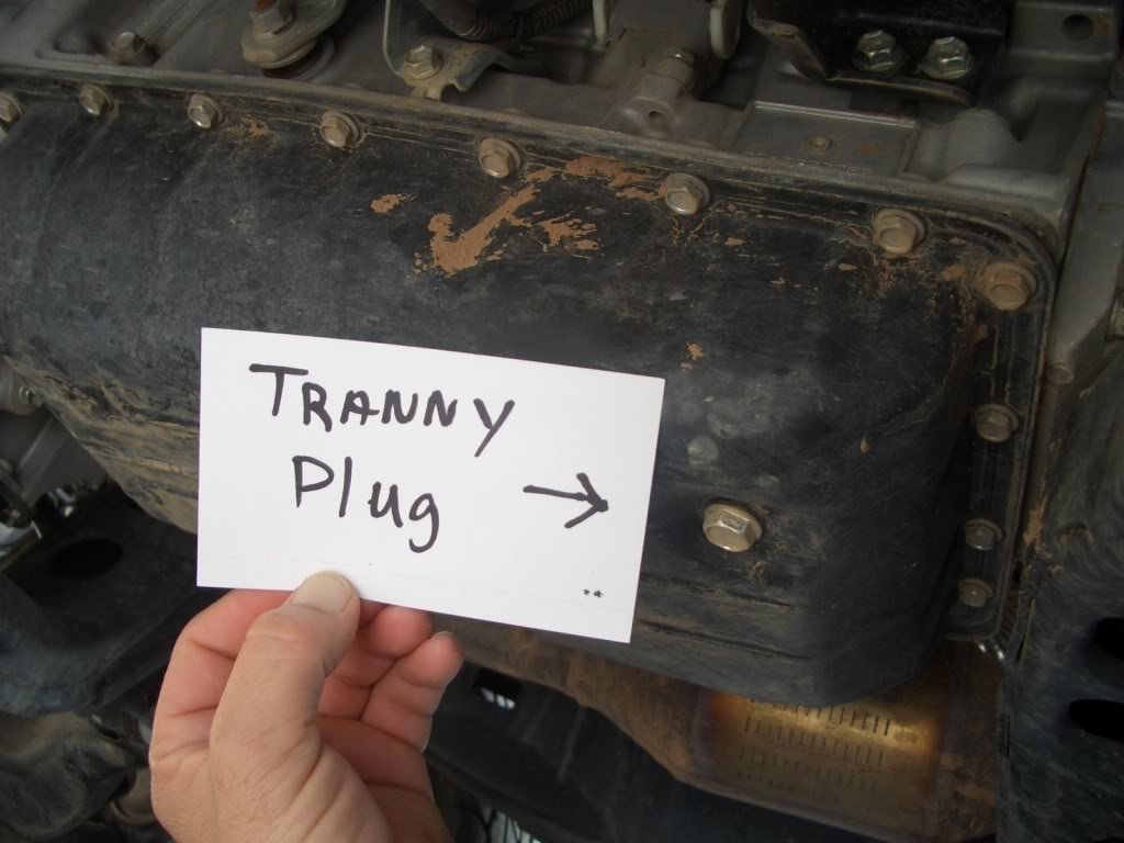

    OP, lesson learned but don't let this stop you from learning and working on your truck in the future. Unfortunately this happens more often than not on the Tacomas. Heck, there was a thread here not long ago about a dealership overfilling on an oil change. I web search before any first time repairs or installs on all my vehicles, from oil changes to lifts. I did a double take the first time I creeped under the Tacoma for it's first oil change and can see where you made the error. Both pans had the the same color and similar bolts. I painted my oil pan bolt head to eliminate confusion and catastophe that you unfortunately experienced. You could also buy a Fumoto valve to make oil changes and identification even easier. Kudos for being man enough to post your error knowing the possible bashing. We all make mistakes just hope it all works out well for you. Make sure the shop knows how to change the transmission fluid. Here's a link from a TW member that did his own. :
    http://www.tacomaworld.com/forum/2nd-gen-tacomas/63851-how-drain-refill-automatic-transmission.html
