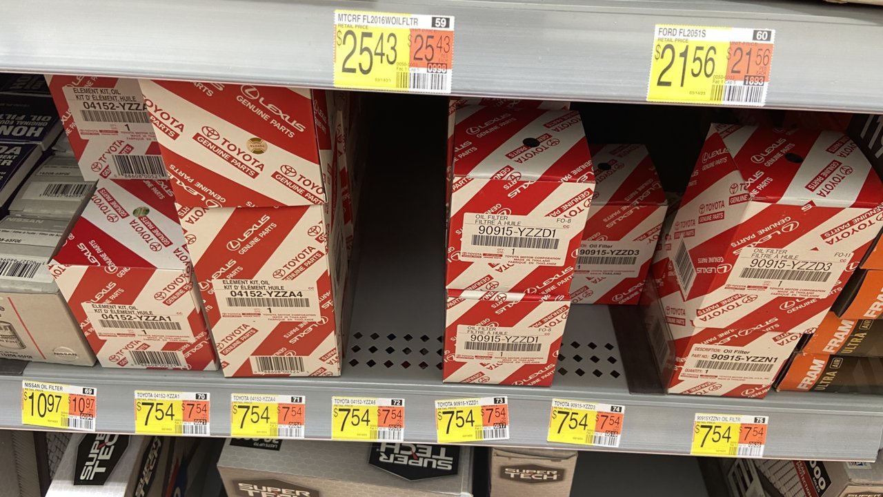

    I get the Toyota ones from Walmart. Just don’t get the cheapest fram

    If you buy a case of 10 Toyota oil filters are competitive with major brands.
    I hear the trick is to look for the anti drain back valve in the filter.
    The sooner the oil is in the is in the valve cover the better.
