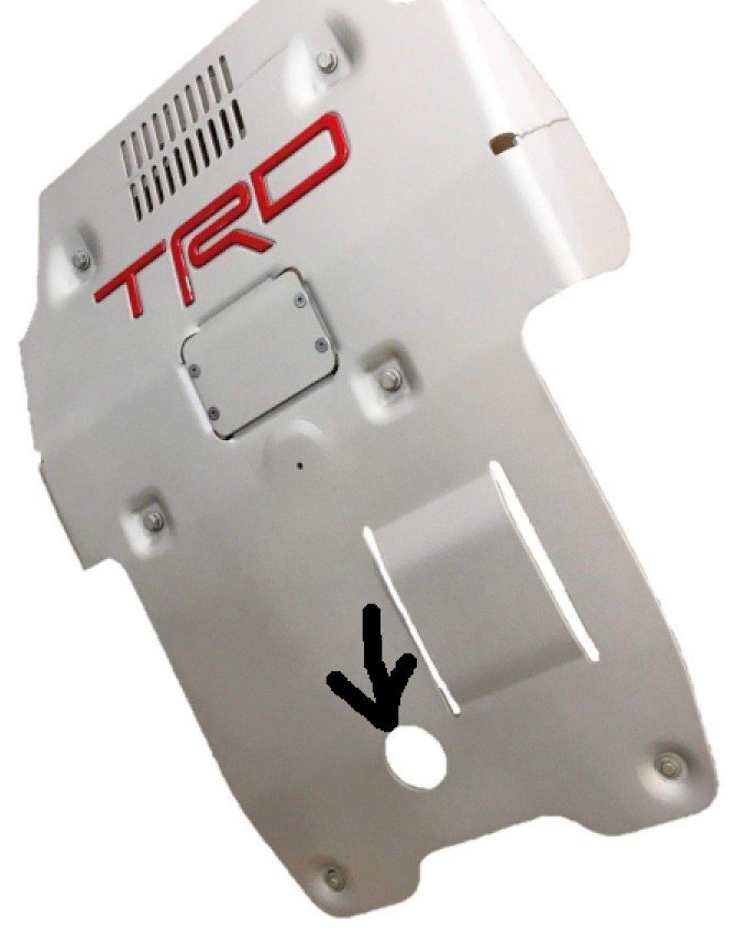

    I have the TRD Pro skid, and it has a nice hole right where the engine oil drain plug is. At first I was tempted to pull the transmission drain plug, but I figured I should verify with the internet, and found this thread: https://www.tacomaworld.com/threads/transmission-plug-vs-oil-plug-v6.757041/ – Phew. That would have been a mess. I'm amazed the OP's vehicle ran fine without warning lights.
    Anyway, here's where the actual oil drain plug on the TRD Pro skid lies, in case anyone finds this thread and wants confirmation. Most videos on the internet are shot from an angle, so I thought this photo would be useful:

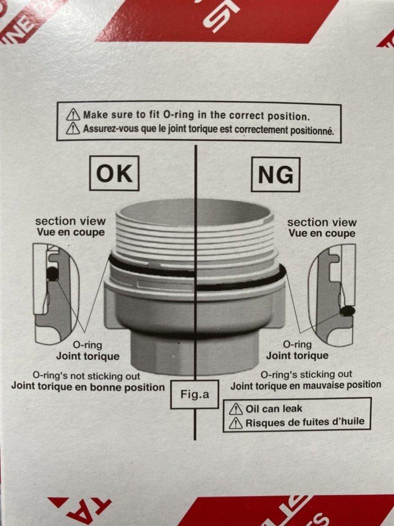

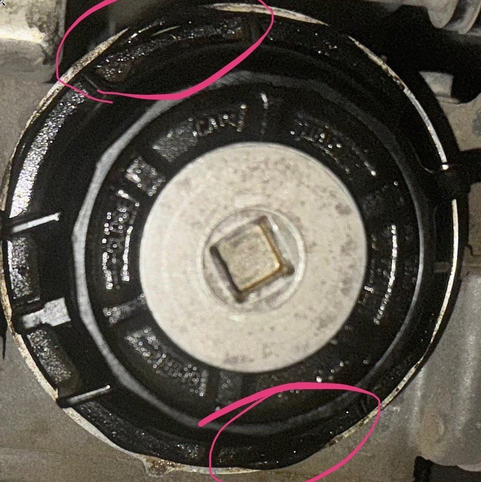

    6. Problematic-looking O-Ring installation
    I don't know if I checked last time, but this time, I ended up with the O-Ring sealing the housing looking like below at the end of the oil change, i.e. the O-ring is not conforming but flares out on two ends at least. I don't know if I messed something up or this is normal. In either event, there's no oil leaks (yet).

    6. That oring is not right.
    Search on here for pics of where it is supposed to it in the groove not all the way at the bottom before screwing it in.
    I have a 2.7, so mine a spin on, but my other 4runner is similar to your 3.5 and that doesn’t look right.
    O ring is pinched.

    Congratulations on wanting to learn and also a very well written mini job documentary.
    We all start at the beginning and make mistakes along the way, never be afraid to ask questions, research of double check things.
    Item #6: The o-ring is not correct and needs to be fixed.
    You can pull the cap off without making too much of a mess, just top up for the small amout of oil lost.
    See the photo below.

    OP, fix that O Ring ASAP look at the picture in @RustyGreen post showing correct installation of the O Ring. Make sure you install a new O Ring and top off the oil as stated and no need to drain oil from oil pan.

    Agree wholeheartedly with this advice. You may be lucky and have no issue, but I'd bet that that you'll have a failed seal with loss of oil soon. You don't want to risk this.

    As others stated, not quite successful. But even the others responding need to watch all of the steps every time, despite the experience they have.
    The O-ring must be seated, and pre-coating the embedded ring with oil helps it slide in the filter mounting hole without jumping.

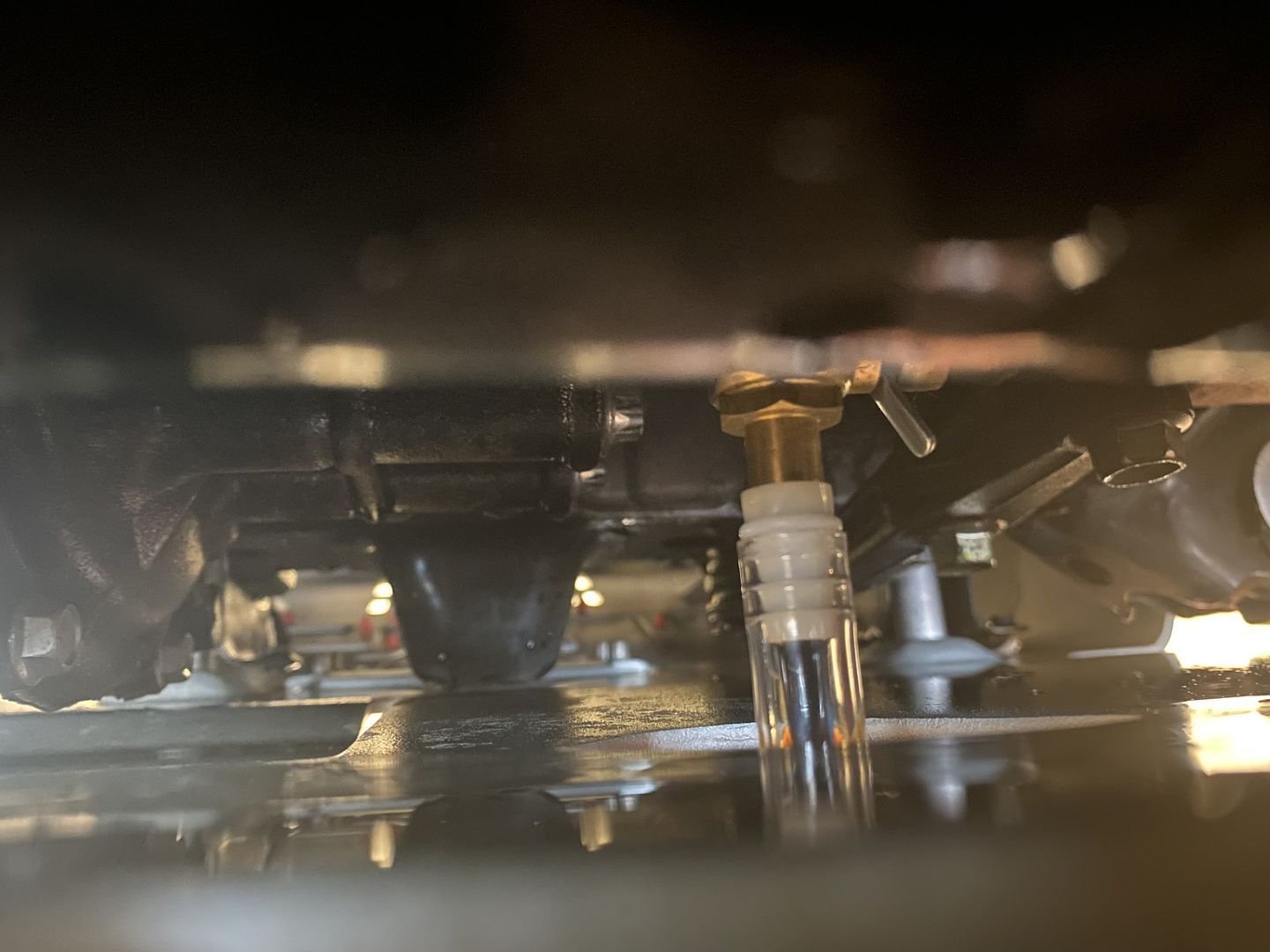

    I have a Fumoto oil drain valve (https://www.fumotousa.com/cars-pickups-toyota-2022-tacoma-3-5l-v6) to slowly/controlled drain oil instead of a single big hot flow-mess. Open enough to see where the oil is going, adjust the drain pan, let it go. Short nipple, long nipple, no nipple ... mainly affects if you can or cannot attach a hose to redirect the oil directly into a container.
    Get a Motivx oil filter wrench ... grabs the filter at the strongest point and lets you more confidently install/remove. https://www.motivxtools.com
    Some say they make no mess, others always make some mess despite efforts. Fumoto helps with drain mess, pre-draining the filter by removing the silver cap helps with less mess. Motivx helps filter removal/management without over-torque. But follow steps and pay attention to the big o-ring which does like to slip out.

    Most definitely fix that O-ring on the Housing!
    I have the MotiveX kit and Fumoto which makes the job less of a mess. (You can wait to do this upgrade until you've done enough oil changes)

    You can see where the O-ring needs to go here:
    Fumoto
    There are concerns the Fumoto sticks out too far but the TRD Skid protects it...as best it can.

    Installing the Fumoto, the advice (if not using a torque wrench) was "hand tight, then 1/4 turn more with a wrench". I did NOT crank hard until no more movement was possible.
