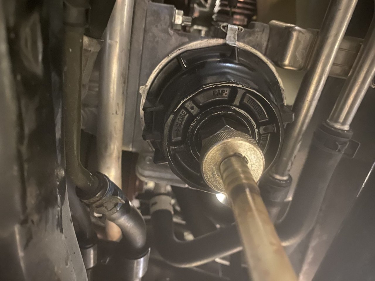

    Yeah, I agree...the aluminum does expand a lil bit.
    Using the housing wrench to loosen it does not take as much effort...but it does feel like it expanded.
    Oil pan bolt/gasket is now replaced with Fumoto.
    The traditional oil filter is replaced by a housing/paper filter.
    The basics haven't changed...just the method of removing the oil filter now involves pre-draining/removing the housing. (Some may not pre-drain)
    The drain valve/hose is part of the MotiveX kit so I go ahead and use it.

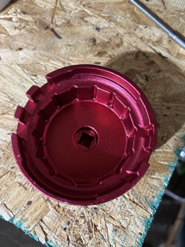

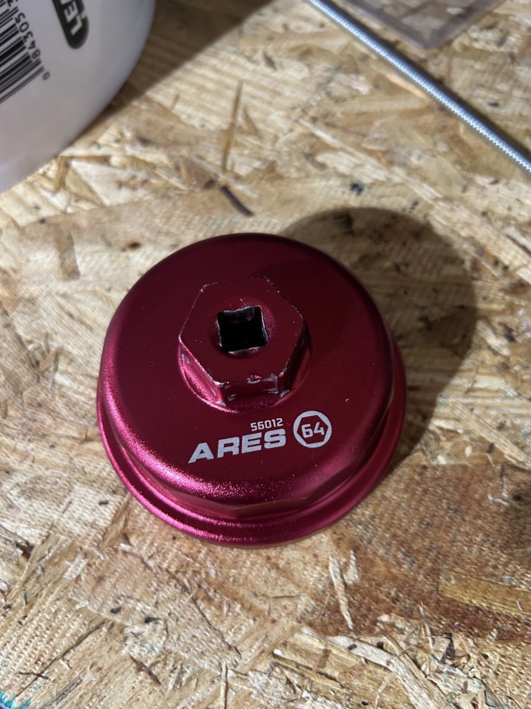

    my 2.7 has the traditional oil filter, but my Camry has the same canister filter, I use a metal canister remover, but I always feel like the plastic is going to snap one of these days. The teeth make it pretty much fail proof.. I prefer the traditional filter.
