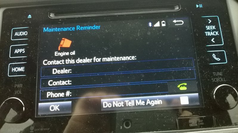

    Anyone get the message for a oil change reminder?? Wonder why my dealer is not filled too. Also I thought it was a 10K oil interval??? This comes on every time I turn the ignition on. Option to not get it again but was wondering if anyone got this and scheduled an oil change. Message started at 2.2K miles.
    Cheers

    Ironic you posted this now as I am at the Toyota dealership because of that .... LOL
    I have 5550 miles on my Taco. At 4500 miles the yellow triangle came on. OF course I was out of town for Thanksgiving and I thought it was the check engine light. The manual says it comes on automatically at 4500.
    The oil change for my TRD OR 4X4 is 10,000 miles. I was going to change it every 5000 ... he convinced me it wasn't necessary. I looked at the oil and it is clean, normally on my new vehicles I would change the oil at 1000 miles new then every 3000 miles. I used to do oil sampling as well, but things have changed in technology and service procedures. I am warrantied until 125,000 miles, so I will follow their recommendations
    I will see if they reset the warning properly as well.

    The radio maintainence is seperate from the maintainence reminder light. The light gets reset at the service interval. Radio maintenance is usually set by the customer so they can keep track. They have had it for years on other models and I have yet to see one actually being used to keep track of everything

    You can set it to come on after a set number of miles. Put in any miles you like. IE I set the transmission flush to come on at 30k etc etc. You can fill in the dealer info. Mine was blank too...doesn't bother me because I know exactly where it is lol.

    It is all in the fine print, service is every 5000 miles. But in the details on what service is done, the oil is not listed as a change item at 5K. Instead it only shows the oil changed every 10K. There is a statement saying oil would be changed every 5K if driving conditions were short trips where the engine never got warm and or dusty and dirty conditions.

    Thanks guys - its definitely a oil change reminder, the display changed last night after I stalled my truck (popped the clutch with the hand brake on) got a different message looking more serious with an oil can in orange ... I'll take another pic when I start out today and post. Weird I could see say 4500 miles but I only have 2200 miles on it so far. Kinda early for a 5k service for a 10k oil change. Guess I'll call the dealer and stop in tomorrow and get the oil changed.

    Hold down the odometer reset while the car is off(acc off as well) for 3 to 5 seconds roughly then push the start button with your foot off the gas all while keeping the odometer button held down. You will see horizontal lines in the odometer spot go across then you can let go of the odometer button. This will reset the warning light, do it again after your oil change and it will start the counter over for you then so it will come on 4500 miles from your oil change. Just did this do mine when the light came on yesterday at 4500 miles.

    smh, I guess someone needs to read the manual. this screen is explained in the manual and how to setup/modify it.
