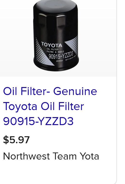

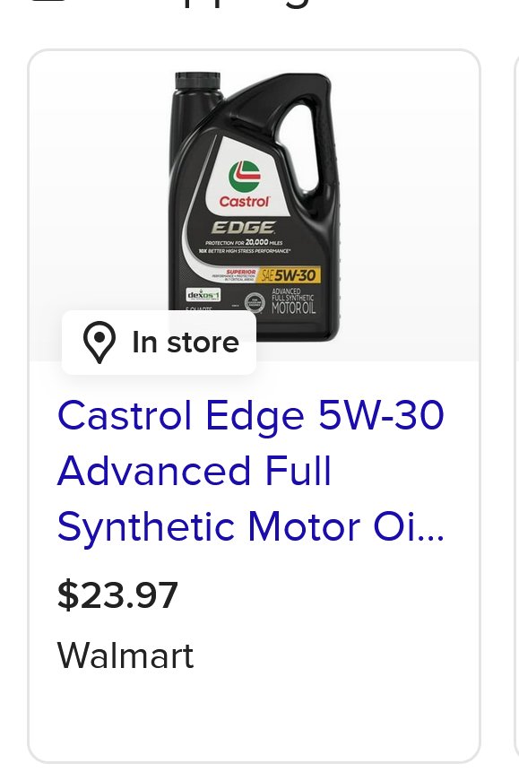

    plus .25 quart bring my dipstick up to the full mark.
    4,000 miles works out to about a year as I have other vehicles that I use also.
    SomeGuy_GRM and essjay[QUOTED] like this.

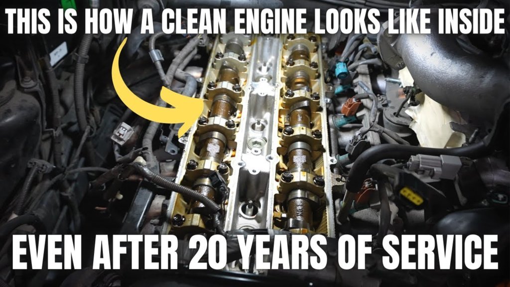

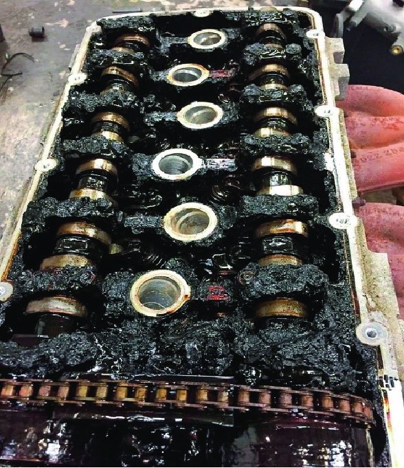

    Indeed. Why change the oil at all? You could just change the filter once in a while.
    At what point does sludge start to form? Yes, most engines will keep running as long as you keep the oil level up. You've never seen clogged oil screens? Flat cam lobes? Oil control rings stuck in their lands?
    Which engine do you have? This...
    Or this
    Look, I've been I the industry since 1982. Done tens of thousands of oil changes. Didn't really see too many problems back then except for extreme neglect. After the auto makers all went with the 10,000 mile OCI (and 20k on the oil filter) we started seeing more oil related issues. Mostly oil consumption complaints. Rarely saw that before.
    Pulling the plug on a $40,000 car with less that 20,000 miles and less than a quart comes out. Yeah, that's awesome. Re-ringing cars still under warranty, not so much.
    So, anyway , you do you. I'll continue to baby my stuff and not give it a second thought. I'll save pennies somewhere else.
