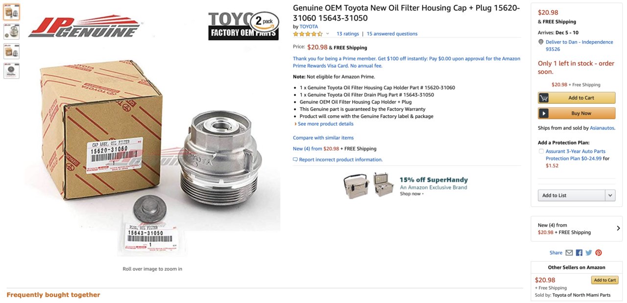

    Yup. Maybe just do it with a impact drive. But I'd buy the metal replacement ahead of time because they are over torqued from factory. Some have broken theirs.
    Upgrade to this:
    15620-31060
    Worth it in the long run.

    Breaker bar and a pipe cheater is what I had to do. Unbelievable. I also switched to a metal filter along with a FUMOTO.

    Yep. The aluminum filter housing is the way to go. $21 on Amazon today.
    https://www.amazon.com/gp/product/B07984MX2G/ref=ppx_yo_dt_b_asin_title_o00_s00?ie=UTF8&psc=1
