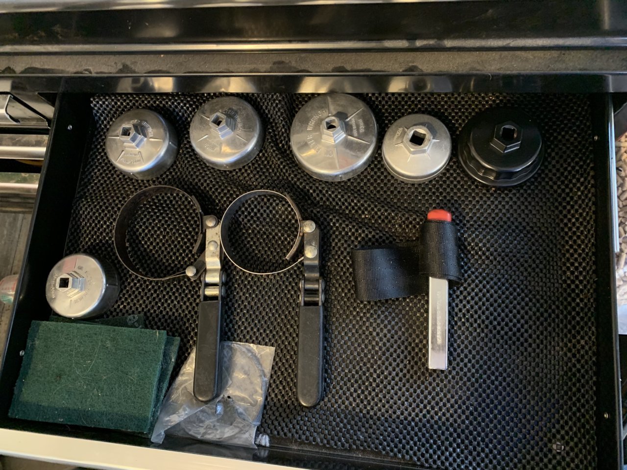

    I have been changing my oil for 40 years. Started every 3k miles now we are up to 10k. Never had a problem with oil filters until now has always been simple for me.
    Now after 40 years any countless oil filters, this one requires effort.
    Is it me forgetting how to change oil after forty years or the design.

    Maybe, but even with the skid plate removal, the job is not that difficult.
    As a community we should probably be trying to encourage diy instead of dissuading it.
    Nice!
    Go get em...

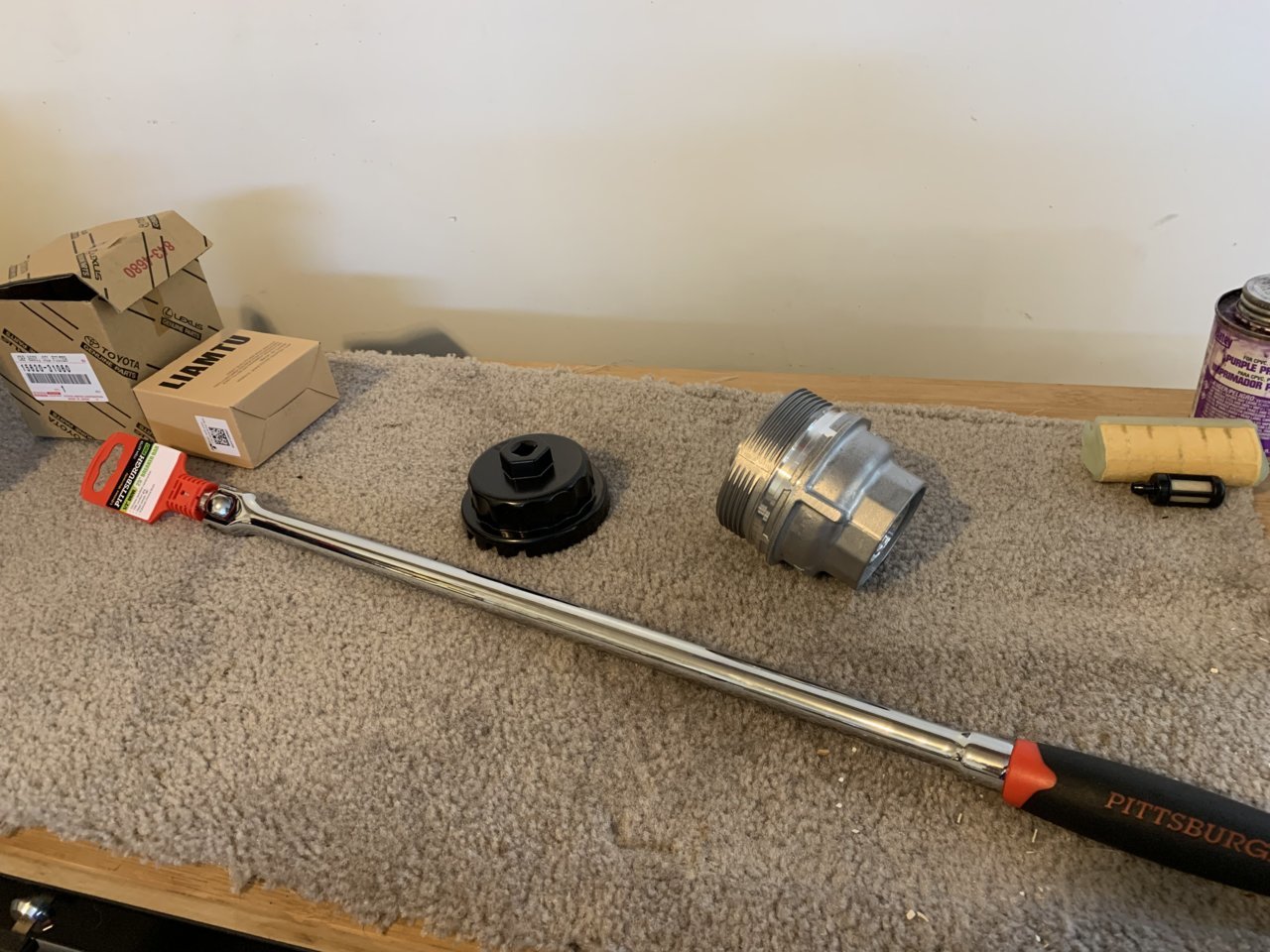

    Oh deer, I hope that breaker bar is to get the old one off only. But since I don't see a torque wrench I'm hoping there won't be a sequel to the OP.

    Thoroughly oil the threads on that aluminum filter cap to prevent galling.
    Did you get OEM or Dorman P/N 917016?

    I'd say it's your refusal to accept that the cartridge design functions differently than the methods used on the throw away filters you have changed for 40 years.
    Sure the first time might be an issue, mine was really tight from the factory. I had to grip the plastic housing in a bench vise to remove the metal drain plug. But since then no problem, but then I don't tighten the plastic housing or the drain plug like I'm torque the cylinder head of Cat diesel either.
    The biggest bitch is taking off the skid plate...and that's just a minor annoyance, not enough to get me to pay $400 for the TRD Pro skid plate w/access hole

    This is why I steered clear of the metal housing. Al on Al plus heat and cool cycles is a disaster waiting to happen.
    My housing was only hard to get off once, after the second free dealer change at 20k. Since then it's been no problem. The housing doesnt need any torque, it's got an oring. When it's all the way screwed in stop.
