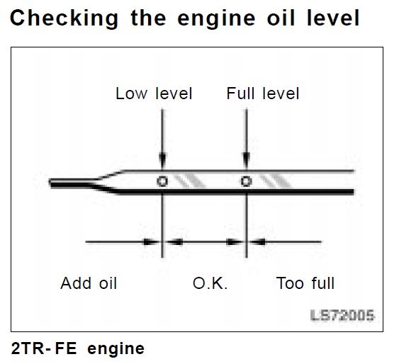

    I changed my oil the first time a while ago and it's coming due again. Looking for info about the discrepancy between the dipstick and what the manual calls for. The listed capacity makes it overfull on the dipstick. Any thoughts?

    Is this a record thread revival? Just fill it to the top notch on the stick..

    That's 1 qt less than the book says, for me. I always go off the dipstick as well, but I've never put more than 5qt in.

    You don't need 5.5 quarts unless you insist on the level being right at the full mark, which is understandable but also unnecessary. One 5-quart jug will put the level in the middle between low and full, which is "OK" :
    6 quarts will put you above the full mark, a practice which should be avoided.
