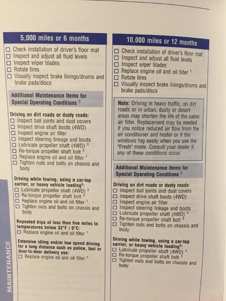

    What page of the manual do you find that it says 10k cause I was looking and looking and can't even find a number on when it says to change it!

    Starts on page 38 of the warranty and maintenance guide

    So when you get to 4500 miles you just reset the maintenance light if your going to change it at 10k? Seems kinda strange, why would toyota have the light come on at 4500 miles instead of 9500...... :notsure:

    Look in the manual that has your maintaince service points in it and it will show oil changes at 10K intervals. Was a little surprised it was that long and if I knew I probably wouldn't have paid for the 3 yr full maintaince pkg.

    The light comes to remind you about Tire rotation.

    There is still technically maintenance every 5000 miles, just not oil changes. I don't think theres really anything at the 5k interval thats overly important that couldn't just be done at 10k intervals.
