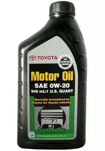

    4. Fill with fresh 0-W-20 motor oil

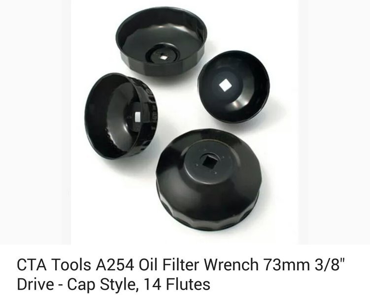

    Just a quick how to ( i have the SR5 2.7L 4cyl ) ... forgot to add that before i start i pop the hood and remove the oil fill cap. Also i have this filter wrench ..

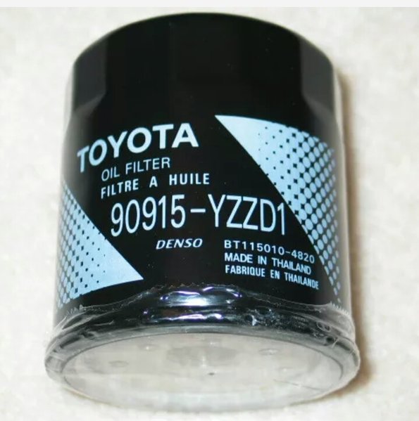

    And i use this Toyota oil filter .. personal preference
    And i would recommend the Toyota 0W20 motor oil but the brand is up to you

    You are quite welcome ! Here is another great tip i found on here ... a case of 10 Toyota oil filters for $37.26, i ordered a case for my 2.7L and received them in about 3-days. Here is link below ....
    https://www.tacomaworld.com/threads/the-unchained5150-the-duke-of-deals-deals-thread.432586/
    He has filters for the 4-cyl and for the V6, you just go on the ebay page and make the offer for $37.26

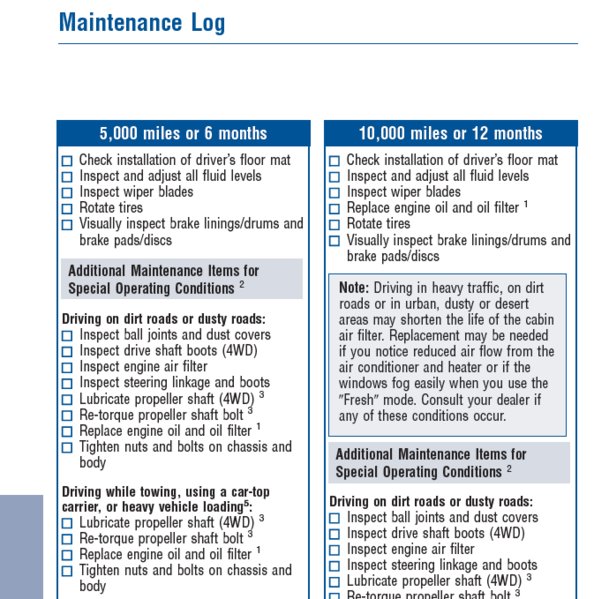

    The '16 Toyota Tacoma warranty and maintenance guide recommends oil & filter change at 10k, page 38.
    Hope that helps
    Cheers!
