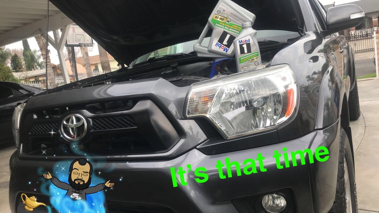

    CE24C5E1-4B08-483B-AE26-0382ACFEBB5C.jpg Owwww yeeeeaaaaaaaaaaaa

    Are you going to 20K, or the most you can drive in a year?

    0w20 is for the 4cyl which makes this truly "special"

    No I used it in my 4.0L it’s fine unless your hauling things and putting weight then the 0w30 is best but for street use it’s just fine

    No this is not the 20k it’s 7-10k recommend. I go 7k

    Sooooo you know more than the engineers that designed the motor,,,,,,,,,,,,,,,WOW,,,, JUST WOW!!!!!!!

    But why would you even want to? From the looks of the background you don’t live in a cold climate.

    Wrong oil

    OP....you're fine. When Toyota issued the 0/5w-20 bulletin years ago the GR family was included on that list.
    Both 0/20 and 5/20 have the same viscosity at operating temps. 0/20 actually makes 5/20 obsolete IMO.

    OP is not fine thats a v6. Xw-30 should be used, not Xw-20..... the latter being too thin to properly lube the motor for our single vvti 1gr motors
