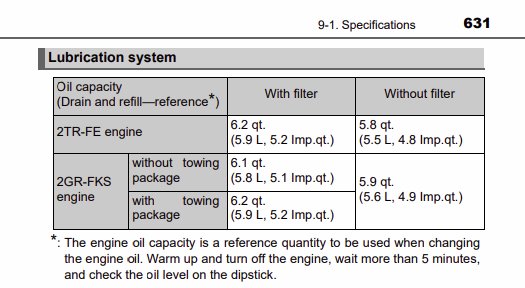

    Toyota dealer has covered my first 6 oil changes on my 2017 tacoma 4cylinder. I was shocked yesterday when I had to pay 90 bucks for my first paid oil change. The rep said it was because its almost 7 quarts and he showed me the printed spec sheet showing 6.2 quarts. I googled this and found that the 2.7L takes 5.1 quarts and 6cylinder takes 6.2 quarts. Can anyone verify this?

    your user manual can confirm the amount. It should list both engines

    Check the owners manual for capacity. But it should be around 6 quarts for the 2.7. That's what I remember from my 1st 2 Tacos.

    6.2 is what goes into my V6. You'd have to check the owner's manual for the 4 cylinder to be sure.

    2.7 uses 6.1 qts.

    Outta the Owners manual for my 19. The 2TR is the 4 banger.
