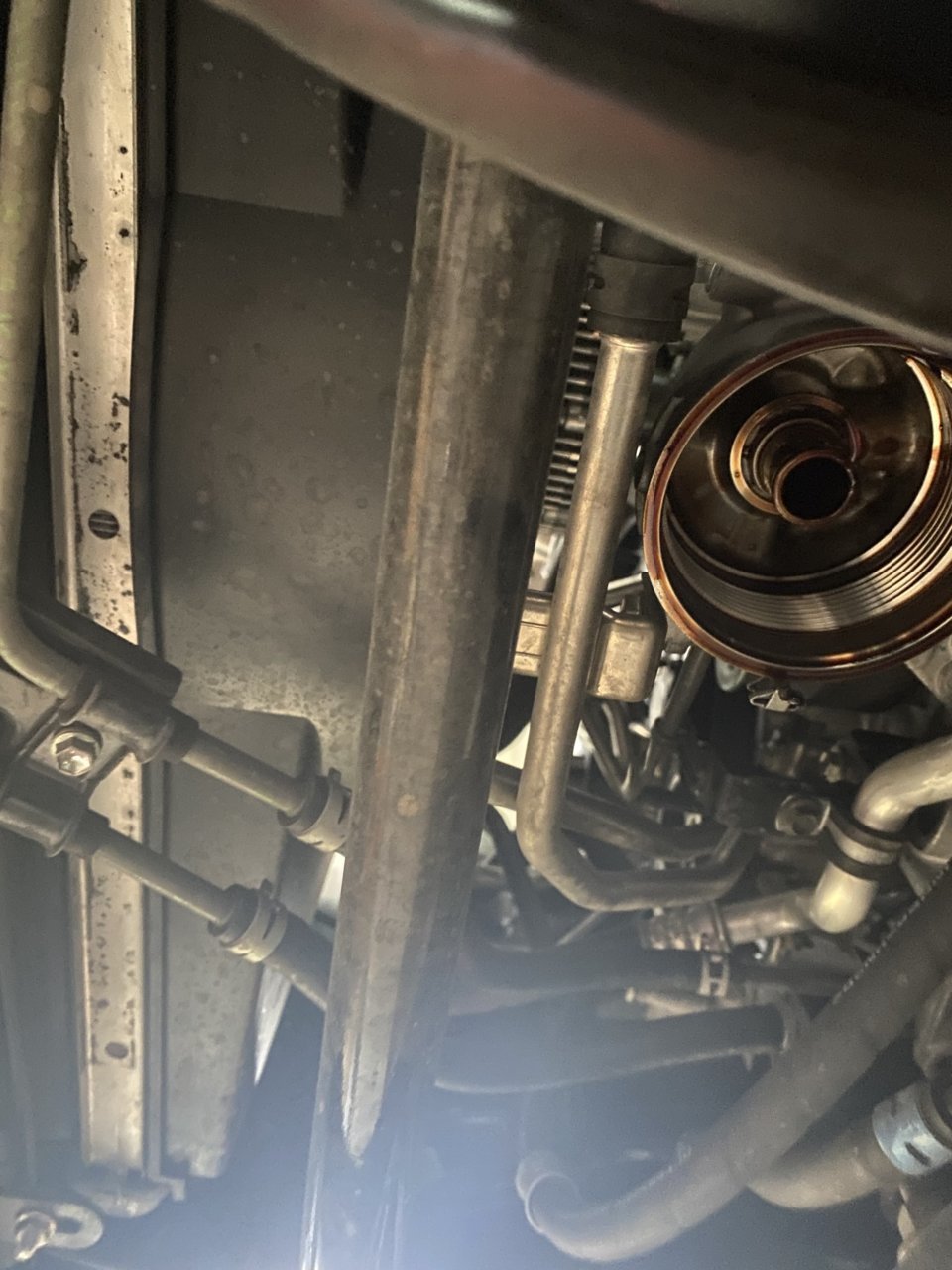

    Hi everyone I’m new to this so bear with me please,
    This is the situation I bought a 2020 Toyota Tacoma sport it came with the service maintenance warranty and they say to change oil every 10,000 miles, well I’m old school I change it every 5000 miles well in August 14,2021 and I had oil change done at the dealership roughly at 14000 miles. Well today at just under 19000 miles it was time for a oil change which I did (every other oil change I do) for the maintenance deal (I hope this is making sense) found out that for the last 7 months 5000 miles I had no oil filter!!!
    Wondering how much damage has been done to the engine? Or how much life has been taken out of the life of my truck? Any help?

    Well I went to the dealership right after I changed the oil. Showed a video of it with no oil filter he wasn’t impressed.. I wish I could upload it on here but keeps having issues

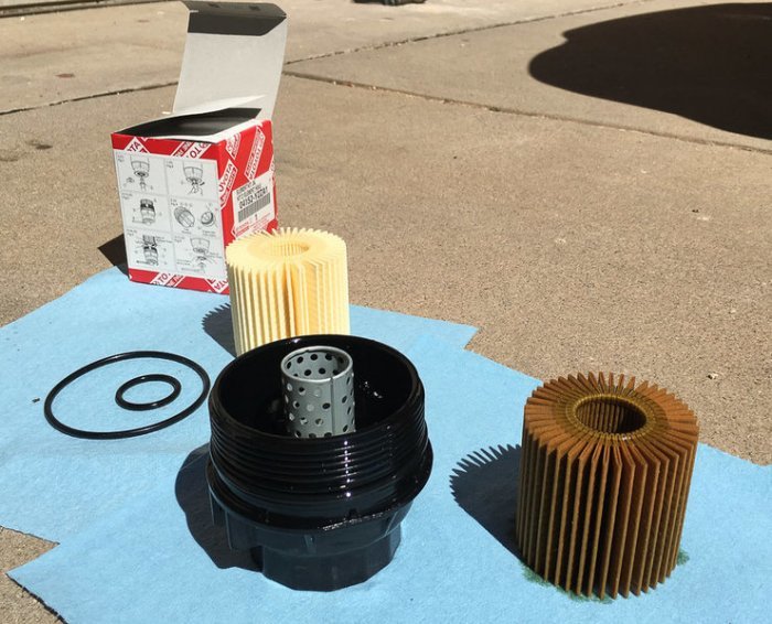

    3ed gen V6 engines use a replaceable element filter. Refer to the photo below, the large O ring goes on the filter housing and seals it with or without an element installed.

    It the canister type not a spin on
