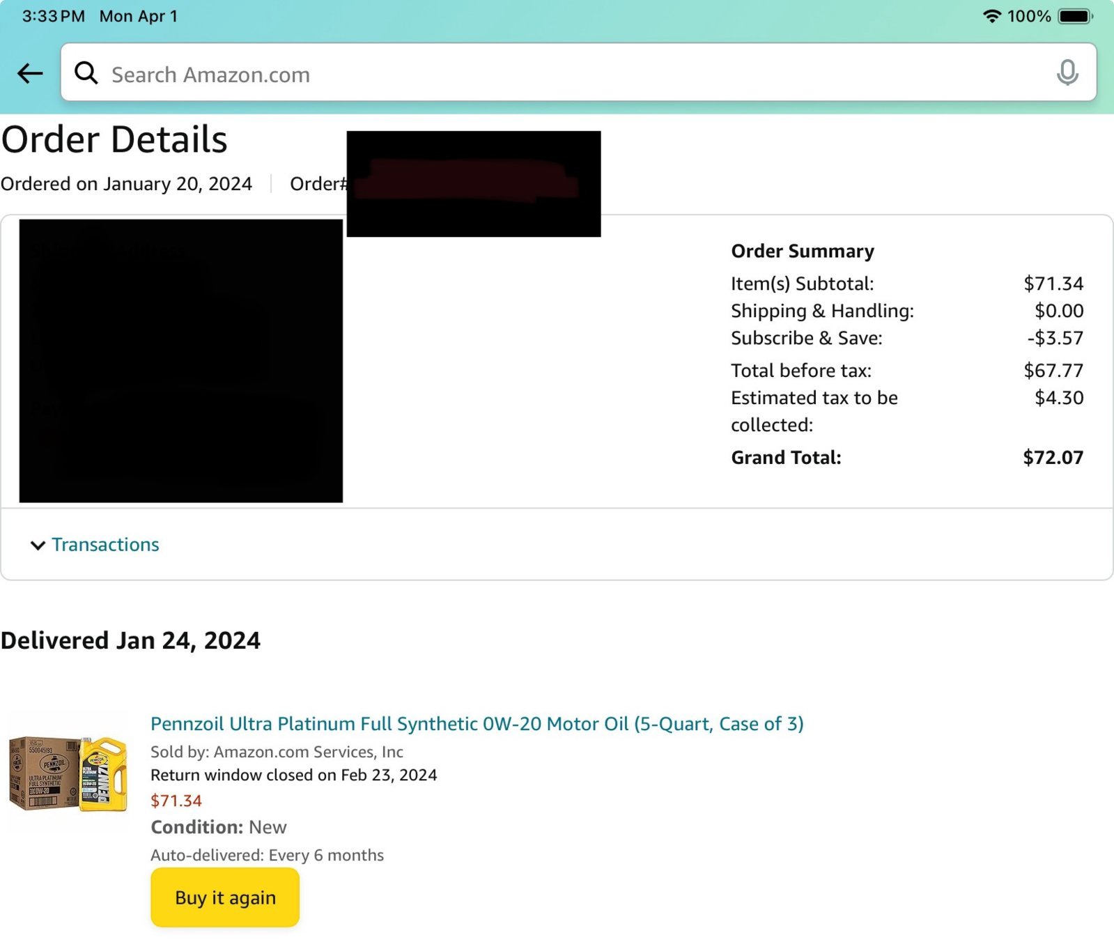

    I’ll do you one better. Better oil at a better price.

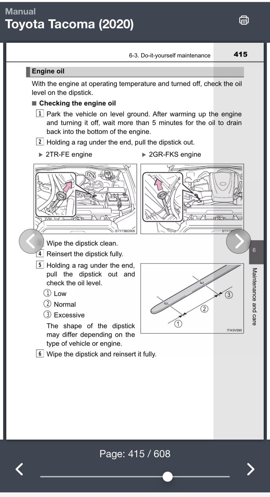

    Ok, wrong. I’ll do it as I have for 40 years. I’ll follow the manual.

    I don’t get it, if you’ve been doing it wrong, and you find out, why not do it right?
    If you check the oil immediately after engine shutdown, not only is it slightly expanded because it’s hot, it also hasn’t all drained back into the pan. If you check it cold you’re ensuring that neither of those things affects the reading you take off the dipstick.

    your comprehension is not catching what I am staying. And I am not doing it wrong, you just can’t understand
    By filling it to the level I do when cold it ensures that I am not overfilling it when the oil is hot. I fill the crank case with cold oil.
    The oil level is still where it needs to be. So unless you are a Toyota engineer, and can prove to me that the owners manual is wrong, I certainly won’t be listening to your opinion

    My comprehension is catching what you’re saying. It was just poorly said the first time around. “it’s a hot fill line not a cold fill line” would have done the trick.
    I guess I’m disproving your “you just can’t understand” statement when I say, clearly I was wrong, as the manual states to check oil level at operating temp and not cold. You learn something every day. Sometimes you get to learn it from someone who is being incredibly condescending, sometimes not, lol.
