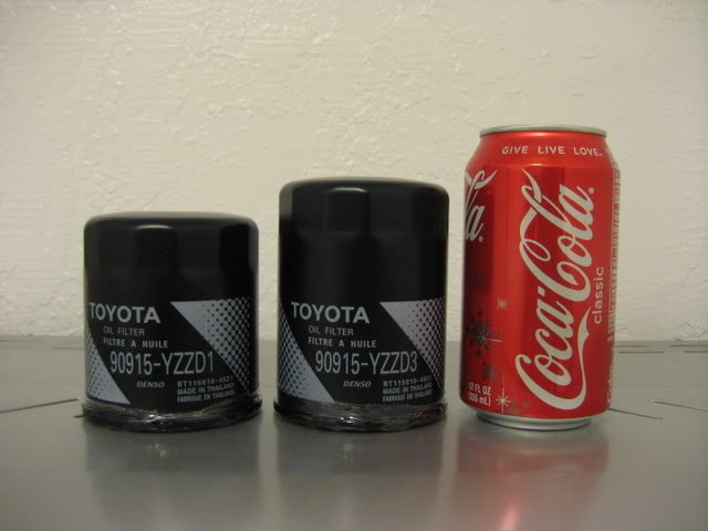

    1. Have had two oil changes so far. The first dealer used the listed 90915-yzzd1 (4 cyl) filter and the second dealer used the 90915-yzzd3 (6 cyl) filter. Truck is fine, but any issues or preference to consider?

    IMG_1702_c72fb854c9bf84681d9b468387753cca8ef3b322.jpg\
    Only difference is the height. The YZZD3 has more filter material.

    YZZD3 is for our truck, same filter when it came brand new.

    This is good news. The larger filter is the way to go and I can put away my grease gun.
