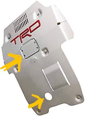

    I'm even more confused about the responses of dropping their skid for oil.
    Do you guys not have filter and plug windows on your skid? :confused::confused::confused:

    Maybe they don't have the TRD? I didn't see these access points in the factory metal when I replaced it. Perhaps it's a reference to factory skid plate

    That's only in the PRO skid plate. The Offroad has two very thin skid plates. One towards the back of the engine that has a cutout for the drain plug. No need to remove anything to drain the oil. The front skid plate needs to be removed to access the filter. It's help on by 4 bolts. Very easy to remove.

    The service manual for TRD Skid Plate specifically ask NOT to remove it for oil change, instead use access windows. I guess it's easier just impact wrench on those 17mm and 12mm bolts than finding a 5mm HEX and mess with that

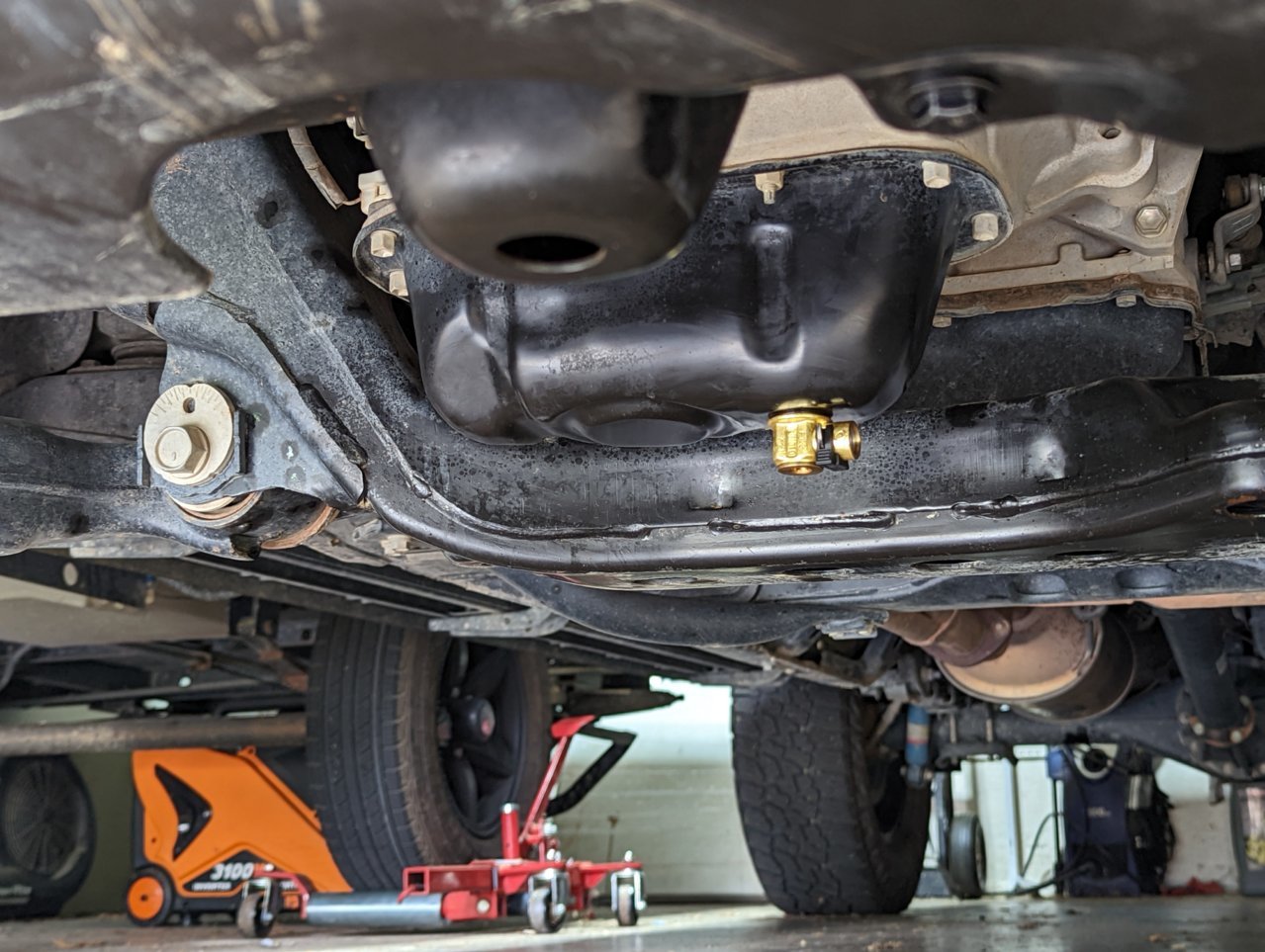

    Get a fumoto valve!! That should at least help with the oil drain plug.
    44-16 Taco, mquibble and Rock Lobster like this.

    I love my valve. But also that valve was the whole reason why I bought a PRO skid. Can't have that brass fitting free-dangling in the wind.
