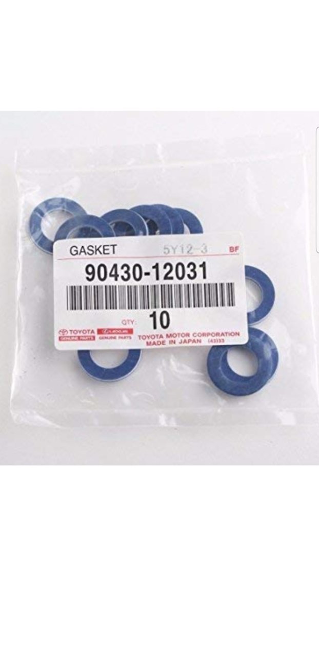

    This is what should be coming in the mail in the next couple of days

    If you bought those off Amazon, they are not OEM. (Fake) I'm not saying they won't work, but be aware.

    OEM packaging has a hologram on it. The reviews of the product state it doesn't.
