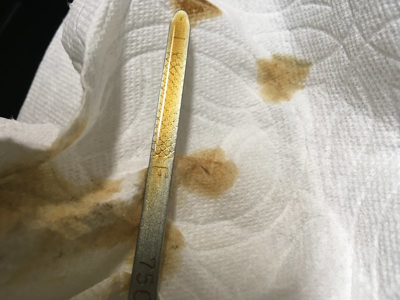

    Here is how my oil looks today almost 6 months ago with 2,000 miles. Do I still change it every six months (conventional oil) or once a year?

    Don't base your oil changes off of time, always go by the mileage (unless your truck just sits for months/years at time).
    For first gens using conventional oil the recommended interval is every 3,000 miles
    btw I don't see a pic attached?

    I have wifi. I just can't find the option on this forum to attach a picture from my phone library. Oh well. It honestly looks pretty darn clear and still at the full mark so I'm just going to do as you mentioned because I couldn't find the recommendation mileage interval for 1st gen tacomas. Thanks man!

    At 2,000 miles I'm sure your oil is still just fine, I change mine on my 2004 every 3,000 miles and it still looks practically new when I go to get it changed (golden yellow). I do a lot of off-roading too and it still looks good, but I go every 3,000 as recommended to be safe

    Oh yeah, that oil still looks like it hasn't even lost it's virginity yet. I think you're good esp considering it's only been 2k miles.
    I bet I could go to 5k between changes but with the off-roading I do, I stick to the 3k interval just to play it safe. Conventional oil changes are cheap, I'm looking to learn to do it myself one of these days to make it even cheaper.

    The maintenance booklet in 2000 specified 7500 miles or 6 months, whichever comes first: http://www.toyota.com/t3Portal/document/omms/SMG100_MS0001/xhtml/SMG100_MS0001_0001.html?locale=en
    The maintenance booklet in 2015, with 15 years of oil technology advancement, specified 5000 miles or 6 months, whichever comes first: http://www.toyota.com/t3Portal/document/omms-s/T-MMS-15Tacoma/xhtml/T-MMS-15Tacoma.html?locale=en
    Moral of the story: don't exceed 6 months with conventional oil. Oil can absorb moisture, turn acidic, etc. just sitting there. @Albinator is putting fewer miles than "typical" in 6 months.

    Todays oils are definitely better than yesterdays oil which in my opinion was garbage but if i were you I'd send in a sample to get the oil checked, and would stick to that oil from here on out running whatever extended interval the test shows is acceptable. You really can't judge oil by it's color. IMO it's easy to give shitty advice on the internet, I would personally do what i said if it were my vehicle and take the guess work out of it especially since getting oil tested is cheap. There is more to oil than color and mileage.
