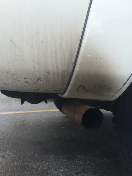

    Luckily Florida doesn't have emissions testing. BUT WOW 750000 miles!!! That's crazy what were you doing with your truck?!? I can't find any pics of the 2.7l pcv valve if anyone has one or knows a link let me know please!

    Robnik is right. He knows what tends to happen. Robnik, what is that, a $900 repair?
    Florida? JUST TOP OFF!! It will run fine. Keep a rag and a spray bottle of detailer handy.

    There is no perfect answer. I say just top off, clean right rear quarter panel, and go for .5 million miles !! Gawd what I went through with cats and Cali smog laws. Move out here. Meet the man known as the "Smog Referee." LOL.

    I replaced the PCV (it was still good but im glad I did). I went to the base auto hobby shop and the tech told me that the black on the quarter panel is exhuast from gas not oil because if it was oil it would be blue? And that a compression test/ leakdown test wont help me identify an oil issue. Any thoughts?
