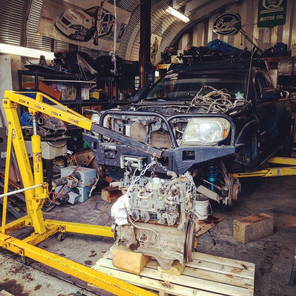

    If you do all of the above and there are no leaks whatsoever, I'll bet hard that the oil control rings have let go. I had the exact same issue. I didn't loose power or mpgs until the cat plugged with oil. Currently rebuilding the engine

    This is where my oil consumption ended
