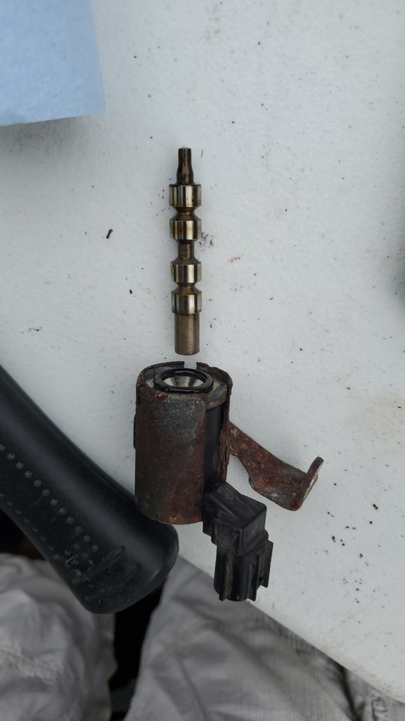

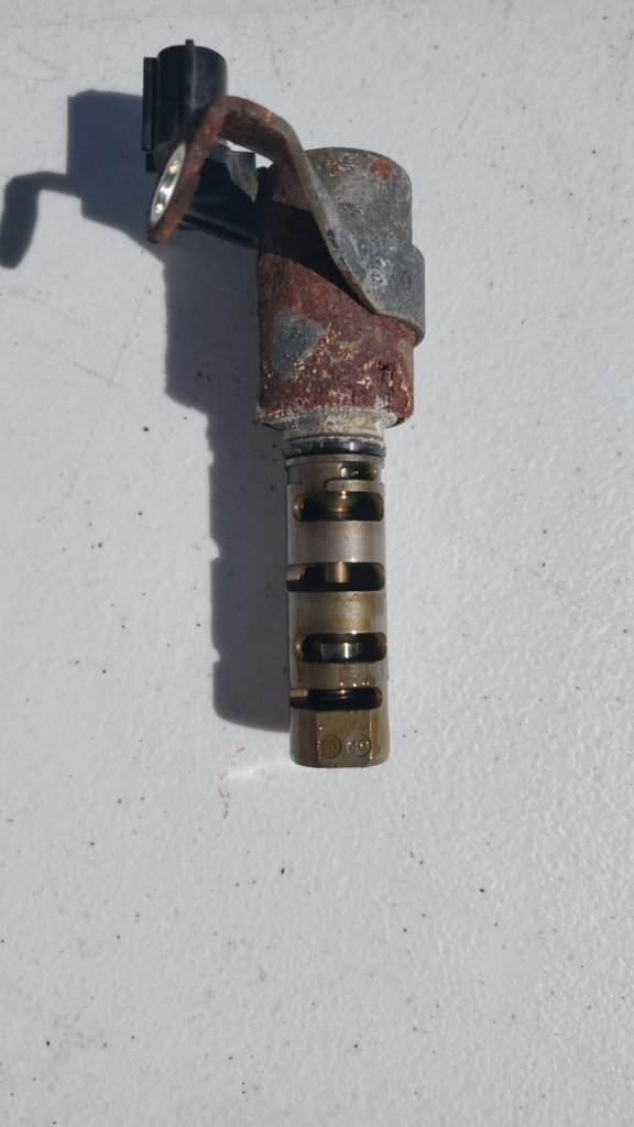

    Read through my thread here. Same year truck, same codes. You can see in the pics on page 3 one of my oil control valves was sticking just slightly. Even though it tested good electrically. You are probably in the same boat.
    https://www.tacomaworld.com/threads/1gr-fe-bank-1-vvti-issues-p0011-p0012-p0016.770671/
    FYI be prepared to fight with some corrosion getting the old OCV out of the aluminum head.

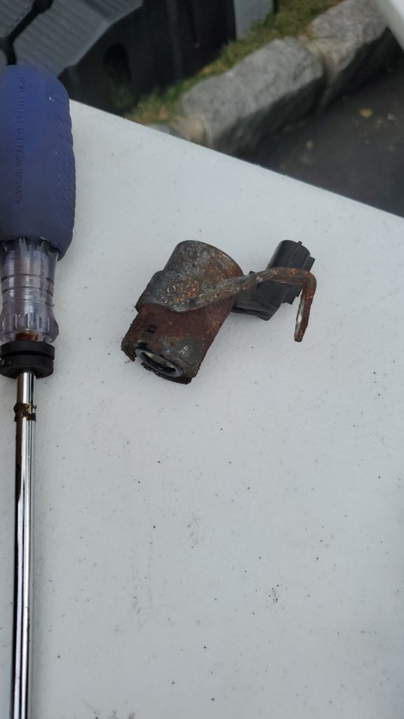

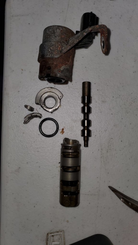

    Phase 1, got the replacement OCV and when I went to carefully! Remove the valve with a screwdriver prying from the back, the housing broke off. Sadface. Going to thread a 1/2 inch course threaded bolt into the opening to see if I can get it to catch and spin the remaining housing off. Thoughts?

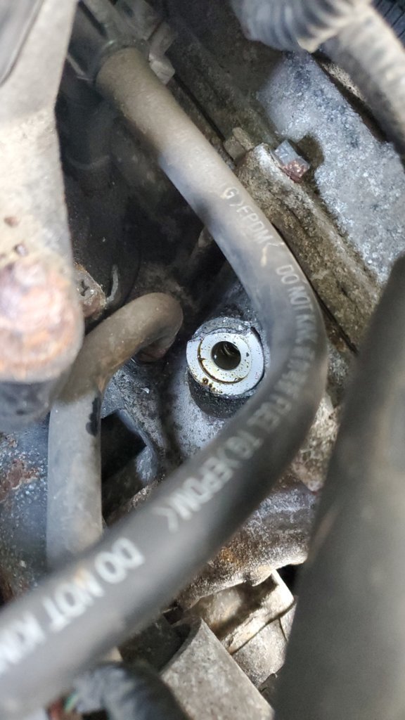

    Ended up breaking another couple pieces of the outer housing off as i tried to pry it off with a screw driver and hammer. Used a 1/2" lag bolt and threaded it into the valve body, picked up a slide hammer and tried that as well, which broke another chunk off. Then was able to get it to slide inside the housing and used a 3/8" threaded screw to push it against the wall as i slowly pulled the rest of it out. HappyFace. Will get the new OCV in tomorrow and hopefully that fixes the shuddering.

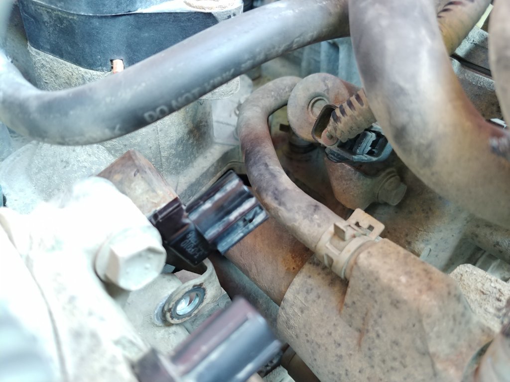

    Got the new OCV installed yesterday, plugged everything back in and it ran like new for about 2 miles, then check engine light started flashing, and got a boatload of new codes.
