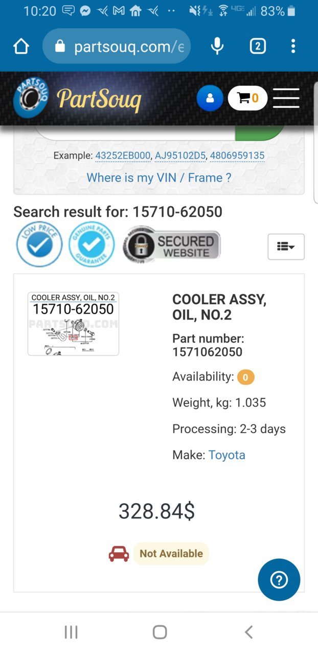

    Partsouq has 12 in stock, for almost $600 less than you're quoting.
    Just saying you got your solution within minutes of posting.

    Got a link? I would to get one at that price.
    This is what I find...
    https://partsouq.com/en/search/all?q=15710-62050
