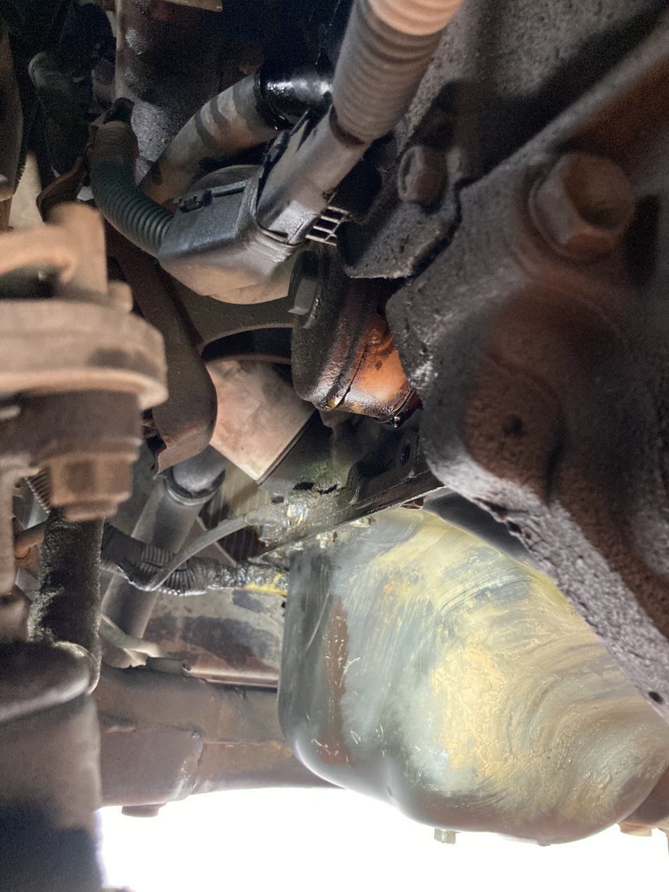

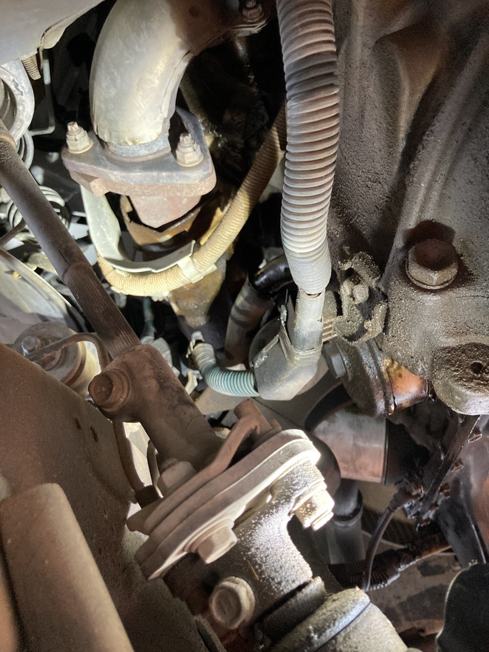

    Truck doesn’t leak at all over night. Drips a little at start up in the morning off the bottom of the oil cooler. Valve covers just done and no leaks there. Is it the cooler o-rings and if so why does it only drip in the mornings

    it could initially leak from being cold and then expanding due to heat...
