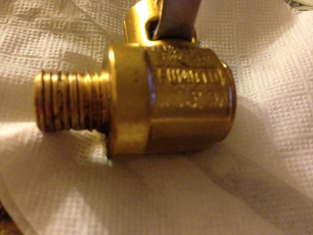

    I have the Fumoto drain valve on for a while now so I'm not concern about removing gasket or over torquing drain plug these days at every oil change.

    That's my next purchase. Just ordered wet okoles and will get Fumoto next month. Which valve did you buy?

    I got the F-103. Be very careful and go easy when tightening this darn thing. I bought this thing for my car and due to its low clearance, I was trying position this thing so tall grasses or other road debris don't hit the handle and shift it to the drain position. This thing got fuccked so easily. Money wasted.
