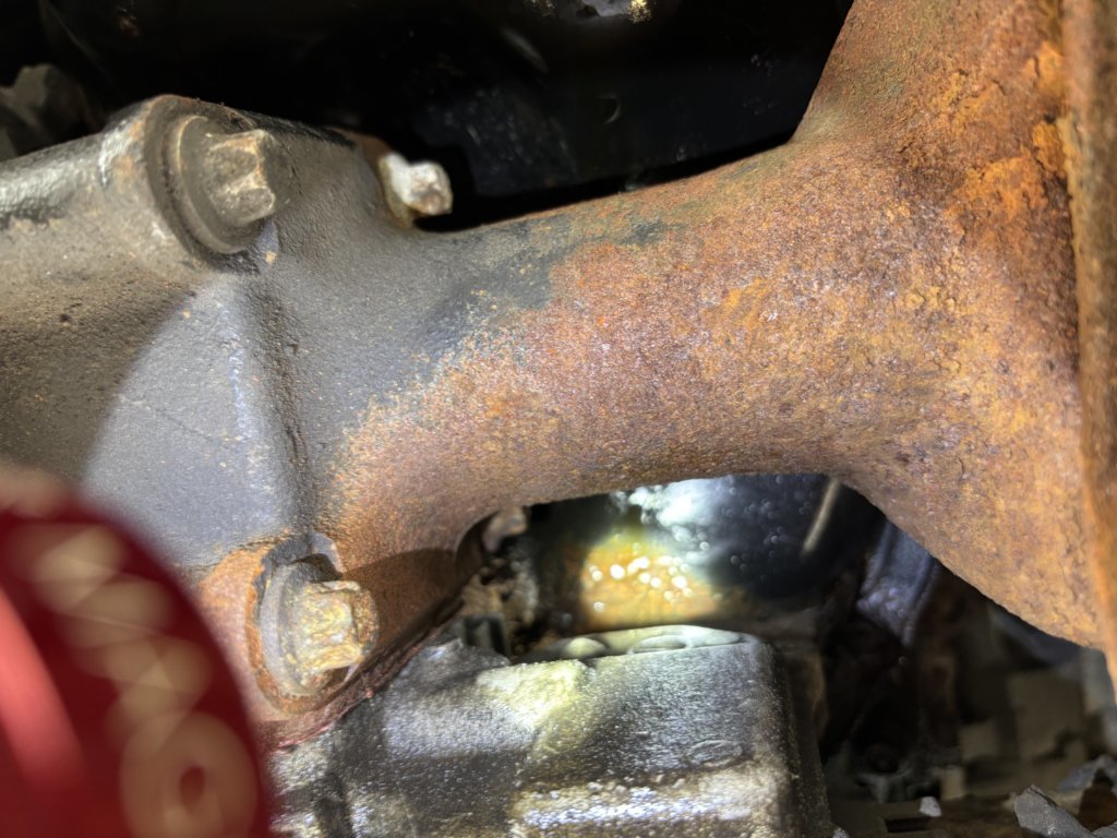

    upload_2025-5-21_11-21-36.jpg Well after closer inspection i dont believe it is coming from the drain plug. I cleaned the oil pan and just let it idle in the driveway and did not drive it so no oil was blowing around. It appears as the oil may be coming from a rusty area on the forward part of the oil pan.
    Hard to tell because of the rusty scale in that area but perhaps there is a small hole rusted in the oil pan. The area that i suspect it hard to get to. In the pics it is just to the left of the front axle. Is this a common problem with these oil pans? I assume the engine would need to be lifted to remove the pan.
    Opinions/ ideas? Im thinking it would even be hard to get to this area to scrape off the scale and patch with JB Weld.

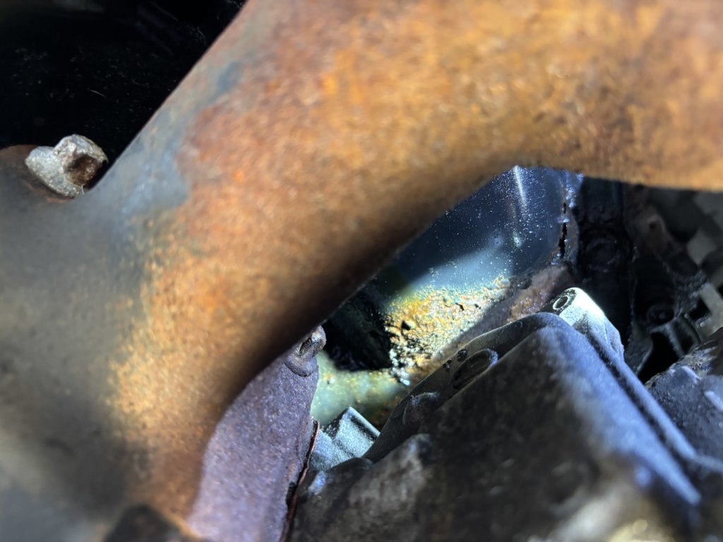

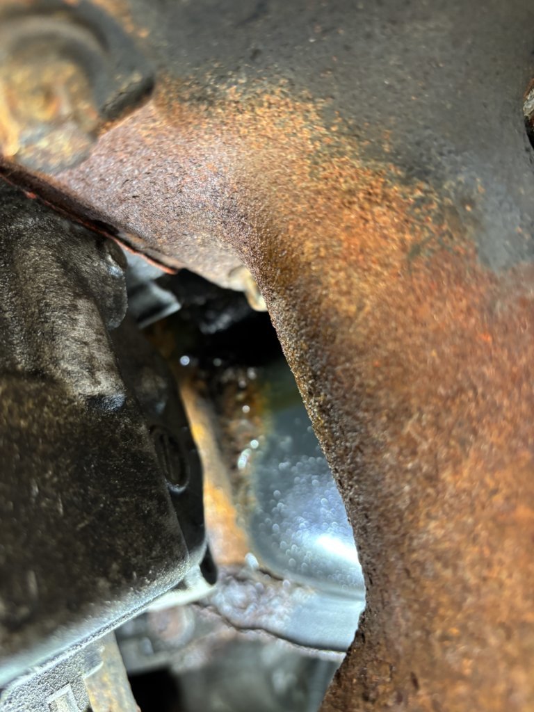

    Maybe a little better pics. The corrosion is pretty much on all the leading edge of the pan.

  17. May 21, 2025 at 9:54 AM

    Well looks like you found it...
    I have no idea what it entails to swap out...
    I thought the pan was aluminum but guess its stamped steal..
    Doesnt look like just one tiny pinhole, even if you can get your bits in there to smear some jb weld on it...
    Prep & cleanliness would determine the outcome...
    Ide start calling some shops for estimates...
    The pan is the cheap part, its the labor....
