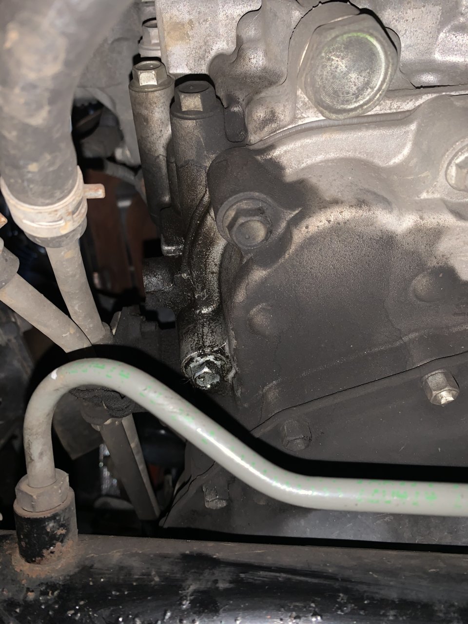

    However, I was also checking underneath the truck today when I discovered something leaky and grimey looking under the engine. I’m not sure what this is but I posted pics below. Any help would be super appreciated.

    am i right in thinking it's leaking from the bottom right corner of the timing cover? If it is, mine has a real slow leak about there too, it's slow enough that i'm not really losing enough oil from there to matter much, just enough seepage to look a little grimy. i just keep an eye on it to see if it gets worse. If you want to see how bad it is, i'd say clean it up and see how quickly the oil reaccumulates.
    I figure it's just the gasket or sealant leaking and the only real fix is to pull the timing cover and replace the gasket, which is not much in parts, but a fair amount of work. so if that falls under warranty and you want to get it dealt with, i'd say $220 is a bargain. Otherwise if it's not under warranty and isn't a significant oil loss, i personally would leave it alone and just monitor it until you have to or want to deal with it. just my 2 cents

    I took it into the servco dealer this morning.. they said my oil filter was not tightened.. either previous owner or they didnt tighten it well i guess..
