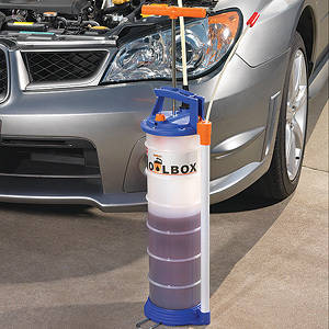

    I have been using this Oil Extractor during my maintenance for Oil/Filter change about 3 or 4 times. What opinion do you all have about using this pump vs draining the oil?

    It works in a pinch, like if you're on a real long road trip and want to change your own oil, or it's really handy if the crankcase is overfilled and you need to take a little out.
    Other than that, I'd stick with normal drains because it flushes the pan out. This is also the main reason why people say to drain your oil when the engine is warm, it breaks free that heavier crud that settles in the pan around your oil pickup and pushes it out. That little tube down the dipstick hole won't do that.
    So basically, not a bad idea, but save it for special times.

    Superx2 - Yes, it works like a charm. It uses vacuum to pull up all the oil via the dipstick access. I live in a very tight environmentally apartment complex that does not allow draining oil and I have to use this pump to avoid spilling. I do the work inside a garage with the door down and smuggle the oil.

    I'd think that if you could snake the hose down the dipstick and position it in the very lowest part of the pan it would do a decent job. The question is how do you know the hose is positioned in the lowest spot in the pan?

    By how much oil comes out. You'll never get as much oil out of a typical engine with an extractor as you would by draining via drain plug, though.
    That said, I've heard that some OEMs use these at the dealership. Don't remember which manufacturer (not Toyota), and don't have any idea if it's true.

    Every time I have use the pump all of the oil is extracted. Each section in the pump represents a Full Qt. I get 5 sections plus a bit more up to the bottom of the letters in the top. I assume the last part of the Half Qt is contained in the filter and residue in the bottom of the oil pan.
    It takes about 15-20 minutes to extract (Hot) or 35-40 min (Cold).

    I have one of these as well that I use at work. But I only use it to drain fluids that don't have a drain plug. I.E. Power steering fluid ,coolant and brake fluid. I also use it to level out engine oil and transmission fluid when I over fill them. It's definetly not a good idea to use this for every single oil change. But as stated before, in a pinch it's a great idea and environmentally friendly.

    I think this is a great idea considering it uses vacume pressure to extract oil. Not for the full drain though. I'd use the drain plug, empty it out, THEN use this little tool. I bet it'd suck .1-.2 quarts of oil out after your typical drain. That doesn't sound like much, but It'd bring peace of mind knowing I got ALL of the old oil out. Will look into this tool. Thanks OP.
