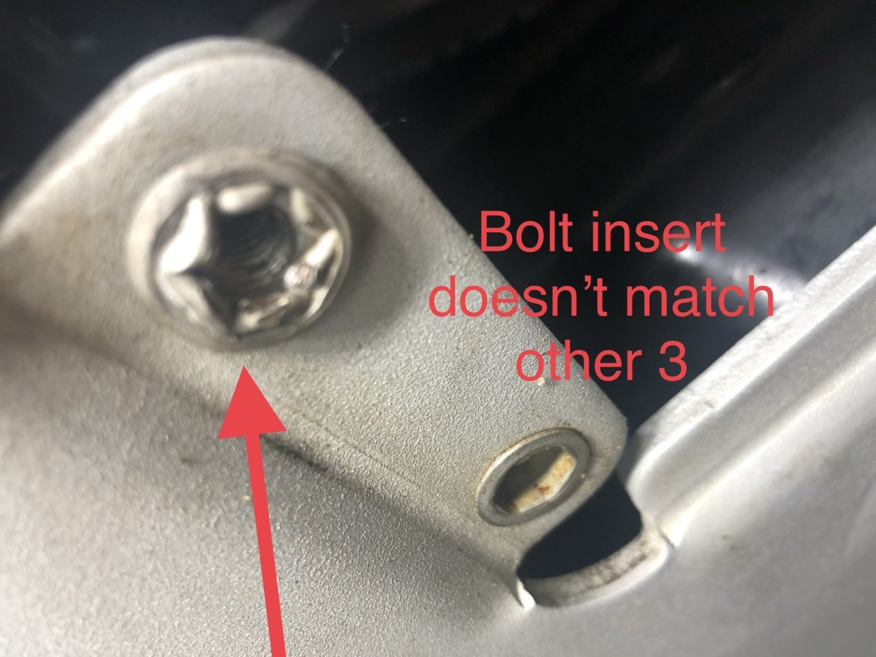

    Looks like another stellar oil change job from Toyota.
    When i had mine done, they didnt use the access door and took off the full skid.. they tried to back the bolts out one at a time which moved the retainers. Then when the put it back on, the bolts stopped by the bolt retainer ring instead of the skid so the skidplate was on crooked
    On top of that, they overnighted the oil canister and drain to the point I’m not sure how it didnt break. I’m pretty sure they used an impact in the 3/8’ hole of the canister drain to tighten it on the truck..

    Mind telling me what size tap and die? Don’t want to buy a whole kit and I already have the handle.

    Take the offer on the skid plate, tell them just put it in the back of the truck. That you'll put it on yourself. Give them the old one. Done.

    I took my vehicle in recently for the first time ever in my life having someone else work on my vehicle. I created a thread about it here Only reason i brought it in was the for the "free" oil change. I managed to get out unscathed minus an over torqued oil filter housing cap. The stress and anxiety was enough to keep me from ever going back.

    yup... same material internal and external threads, great way to get galling

    Yep. Dealer stripped bolt on factory skid on my 4runner last time. There was oil all over filter housing same as yours too but i sprayed engine cleaner and no fresh oil since. They just made a mess during filter change and didnt bother cleaning at all.

    Pull the small oil filter access plate off before you go in, tell them NOT to remove the skid plate. If they say they cant do it then go elsewhere or do it yourself.
