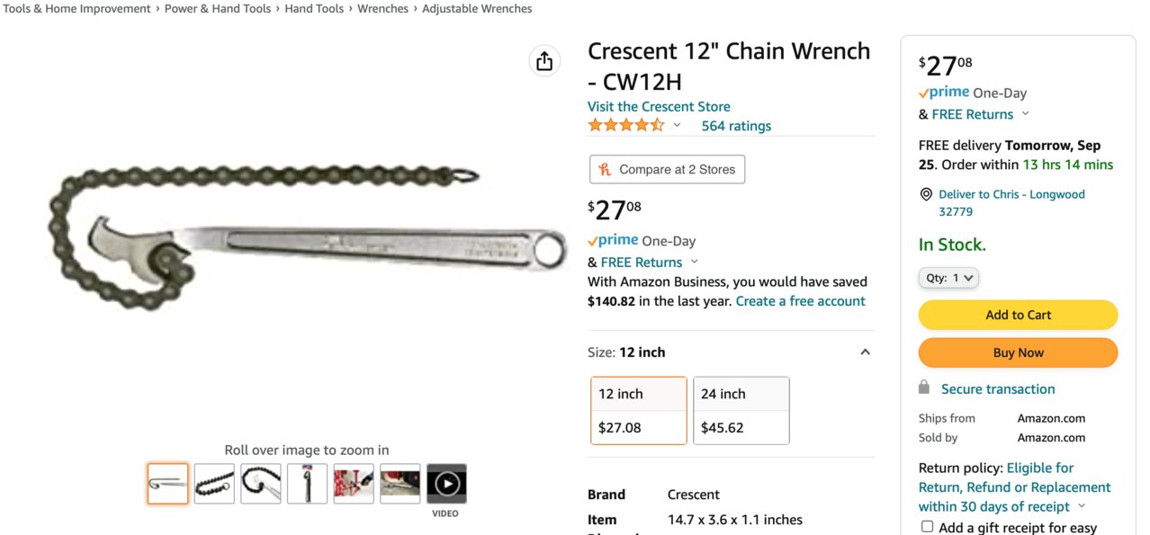

    This has never let me down, it will crush pieces if you're not careful but works so well. Sometimes the rubber strap wrenches don't work well if the surface is oily, the chain wrench does not care if its oily, dirty, muddy, or greasy its getting it off.
    link -- https://amzn.to/3r2zucb
