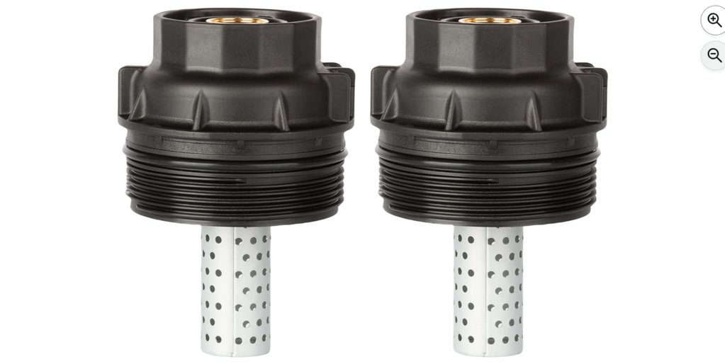

    Correct oil cap. You will not need to transfer anything, not the center tube, not the spring. And it looks like it comes with its own oil drain plug. Good kit. It is a direct replacement for the plastic part.
    I measured the central tube in aluminum and plastic housings with a micrometer (posted pics on TW a while back). Difference was 0.01 of an inch, withing the manufacturing tolerances.
  14. Aug 6, 2025 at 1:08 PM
    Barsoom
    Barsoom Well-Known Member
    Jun 17, 2021
    #368854
    1,892
    NW GA OTP
    Not if he buys part# 15620-31060. It already comes comes with a shorter central tube for a shorter filter that Taco uses.
    15620-0S010 and 15620-0V010, for example (yes, I know they are plastic) come with longer tubes for longer filters.
