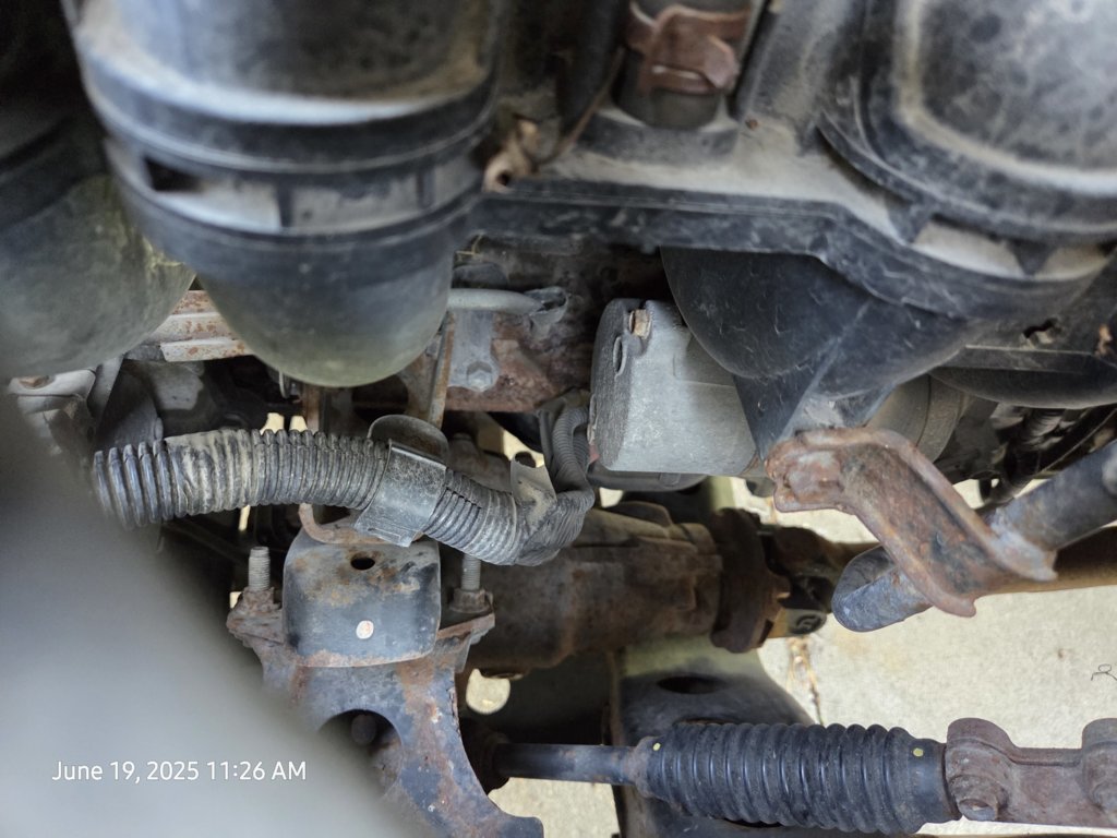

    I've got a 2011 Toyota Tacoma 2.7 l 4 cylinder engine and want to change the oil filter myself. I found the filter but it has a black cover on it with 2 bolts attached. Is this jus20250619_112646.jpg t a cover for this filter? I have looked on the internet and can't find anything similar to this.

    The video I saw on a 2.7 filter change did not show a cover over the oil filter. It was high on the block with the alternator nearby as you viewed the filter up from below.

    I don't see a "black cover with 2 bolts" in the pic, but my eyes are 62 years old. I see a something silver/gray with 2 bolts, but it looks like the starter. Is that a pic of the driver's/left side of the engine? My 2013 has a 2TR-FE, and the oil filter is on the passenger/right side of the engine.
    But now I'm second guessing because I just do it without thinking about what side of the engine it is. Either way, there is no "cover" of any kind on the filter.

    oil filter is on the other side of the engine, no cover is on it.
