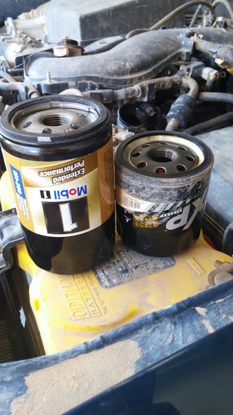

    The OEM filter number is 90915-YZZD3 for those who wish to use it.
    I agree with Plain Jane Taco - if you already have a filter on the engine and I don't care whose it is, keep it and replace when it's time for the next oil change. I wouldn't dream of yanking a pricey Mobil-1 filter just to replace with an OEM.
    There is nothing special about Toyota's OEM filter.
    Tex-Tac, scocar, docbrown and 3 others like this.

    It's almost like there's only a few factories making Toyota filters??? And the higher end filters are just different colored low end filters???? I wouldn't panic over using ANY oil filter, but if I was keeping my pickup for a long time I'd stick with Toyota

    You're not going to notice any performance differences. A larger filter holds more oil; thus, add about half a quart more than what the book calls for. It's peace of mind knowing the larger filter has more filtering media and your oil system holds a little more oil. This is especially of interest to those that like to do high mileage oil changes. So, unless you get the oil tested, you will not see nor notice any difference before/after.

    BTW, these larger Mobile 209, Wix 51516XP, Purolator One PL20195, etc... filters also fit other Toyota products. I currently have a Wix 51516 in my daughter's I4 Camry. I dry-fitted the same filter in my other daughter's I4 Corolla. However, the area around the filter is a tighter fit and my hand rubbed too much on the metal walls. So, I use the OEM Tacoma size filter instead as it is larger than the OEM filter for the Corolla.

    I'm not looking for performance gains. Being supercharged, my oil gets dirty very quickly. I change my oil at 3k and it looks like coffee every time. I figure the larger filter with more media "should" help to keep the oil cleaner between changes.
