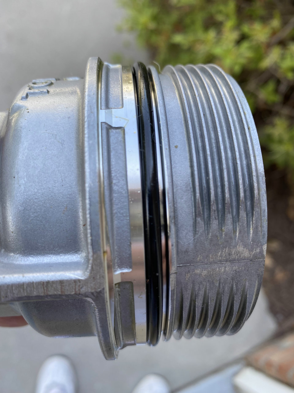

    Yes, O ring is in the correct spot. It's going into the groove right below the threads. Here's a pic of the one installed on the aluminum housing that leaked worse than the OEM plastic housing.

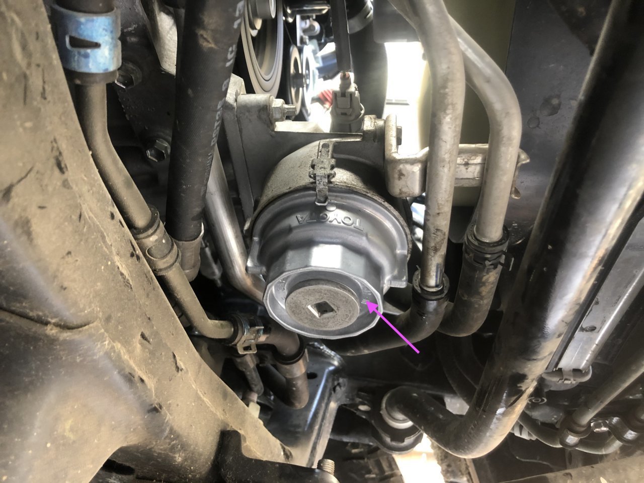

    It's stamped on the housing. Big characters right here:
    OP your housings are getting warped somehow. It might have something to do with your wrench tool or the threads on the truck itself.
