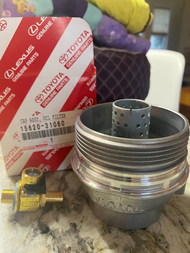

    Is 15620-31060 the PN for the aluminum cap? Amazon lists it as an acceptable replacement.
    Reason I ask is when I lookup this PN on parts.Toyota.com, it does not list the Tacoma as an approved application for the 31060 PN. I’m still under warranty so do not want to risk use unapproved part that might void the warranty.

    @Desert Dog
    Part# 15620-31060 is for the Aluminum Cap but the description says it fits: Avalon, Camry, Highlander, RAV4, Sienna and Venza.
    It does not say it fits a Tacoma.
    Part#: 15620-36020 is for the Plastic Cap and fits the others listed above plus the TC and the Tacoma. (Not sure what TC stands for)
    That's misleading...don't-cha think?
    Why would the plastic one fit the others listed for the Aluminum Cap but not the Tacoma?

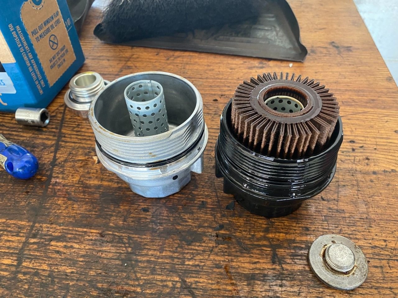

    Here is the Aluminum from Amazon:
    Side by side with my plastic cap:
    You can see the center piece stands a little taller on the aluminum than the plastic.
    That post can be twisted off the aluminum cap since there's a little tension spring holding it in.
