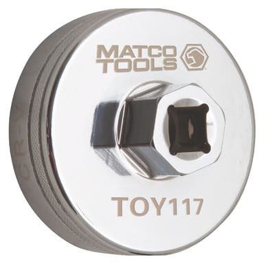

    Where are you located? I can likely break it loose for you. Unless the truck is not driveable.
    Bigger the breaker bar/ratchet the better. The tool you use to remove is also important. I really like this one from Matco below. Broke a few housings until I got this tool.
    Robnik and MrMolotov[OP] like this.
